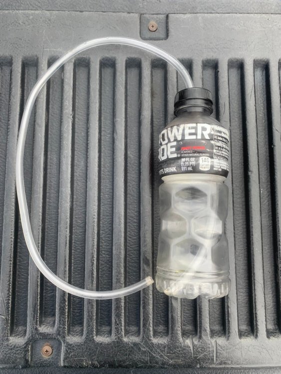

Bled all 4 of my brakes using a home made kit.  Got a poweraide bottle and used 3/16" ID airline host.  Fits nice and snug over the nipple.  Just fill the bottle up 1/4 way with new fluid.  Make sure the end of hose is all way below the fluid.  Just keep pumping.  Can easily tell when there is no air in the system when there is absolutely no air bubbles in the hose.  Can also tell when you don't see air bubbles going in the bottle anymore when pumping.  Once you are 100% certain seeing no bubbles then the system is free of air.  Super simple cheap way to make sure is done right and with no air left in system.  This way helped me flush all old fluid out in less than an hour all 4 brakes.
