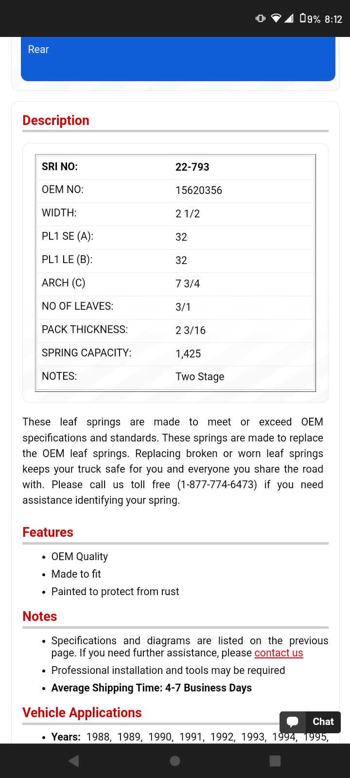

Hey guys, first post here.
I'm looking for information on a leaf spring swap or interchange from gmt800 to gmt400. I have a 1995 Silverado that has broken eyes on the leaf springs. My buddy is willing to give me the leafs from a 06 Silverado. The width and length are the same but the arch is about 1 inch shorter on the 06. I noticed there's a factory lift block on the 06 that might get me that extra inch. What do you guys think? Screenshot_20220630-081245.thumb.png.8fc09f26f90aa3f7ec71596f7a0d87ea.pngScreenshot_20220630-081120.thumb.png.a20c6aae93ad23d317006fcbb3c09b35.png
