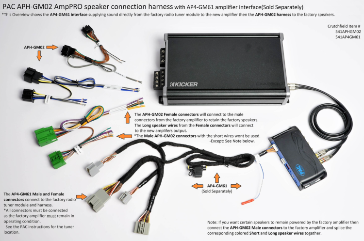

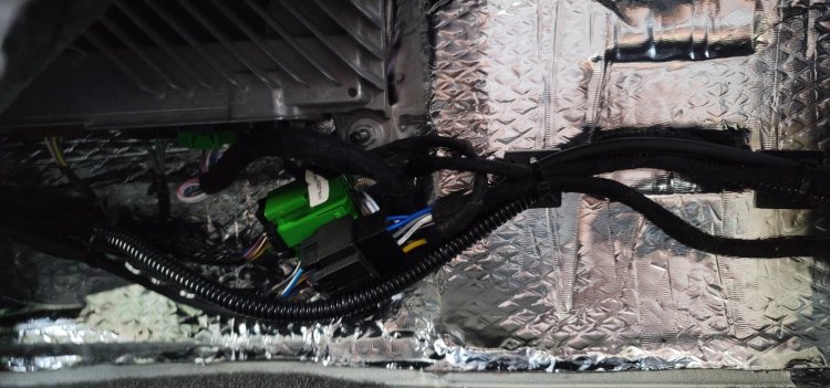

Should visit this forum section more often.... you probably already figured it out, but just in case, buy these 2 so you can add a amp without splicing. Got this my truck and works great. All you'll have to do it use the T harness that comes with the GM61 behind the head unit, run your RCA(front/rear/sub) to the where ever you're mounting the amp and then use the GM02 to T into the BOSE amp harness, you will only use on of them.
PAC AmpPRO AP4-GM61 and to T into the BOSE harness without splicing PAC APH-GM02 AmpPro
This is the T harness installed and running to my amp.
