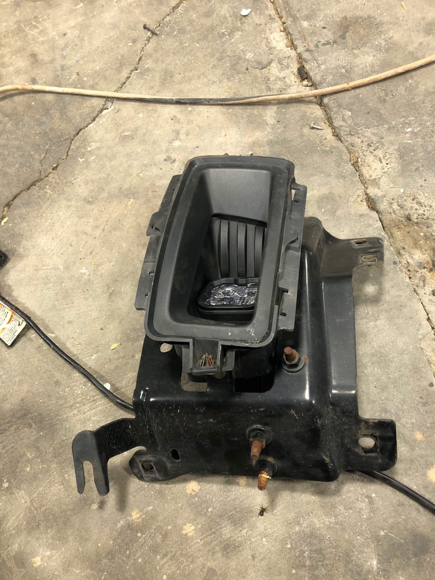

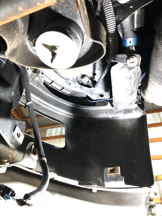

I wanted to check back in and update that you DO NOT have to remove the bumper to install this fog light kit! The first thing to do is turn the tire all the way to create space where you’ll be working, then remove the brace that holds the edge of the bumper to the frame (3 bolts) and remove 3-4 of the lower screws on the fender liner and pull it back to give yourself room to remove the fog assembly. Once you’ve done that remove bolts(6 I think) for fog assembly and disconnect light and slide it out. Take it to the bench follow instructions from Diode Dynamics and reinstall. Once brace and fender liner are back in turn the wheel the other way and knock out the other side. Very easy and worthwhile upgrade!6C99C883-46CC-4889-92E3-90EE0565E186.thumb.jpeg.98cd7db91138171402cb746b77450c73.jpegEC7BE955-3C10-4AD2-AB69-75C4C46AD9AB.thumb.jpeg.c2286e13c96be7b2a5a64ce32bc9346d.jpegDF24C1E5-606C-4F45-A513-8C7155C83E6F.thumb.jpeg.13bb6551b4892f01444486b6cb76e8d5.jpeg
