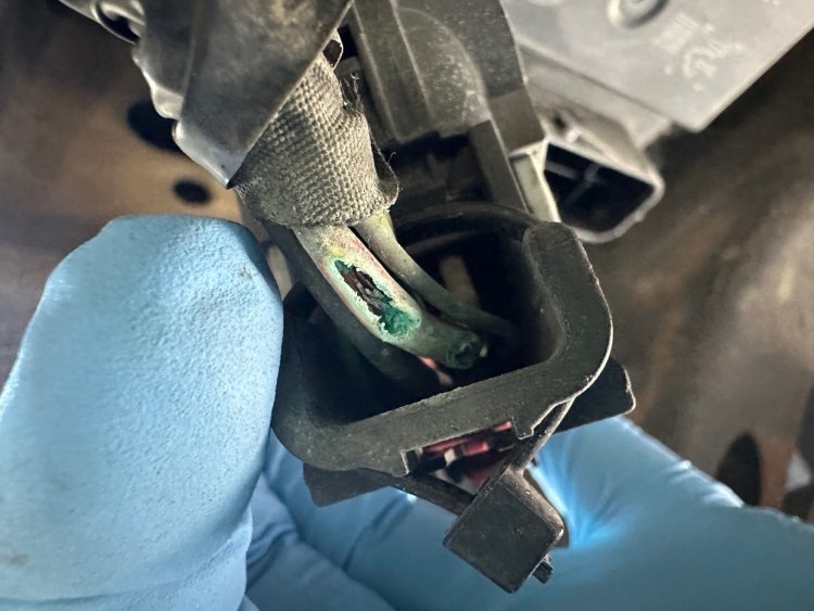

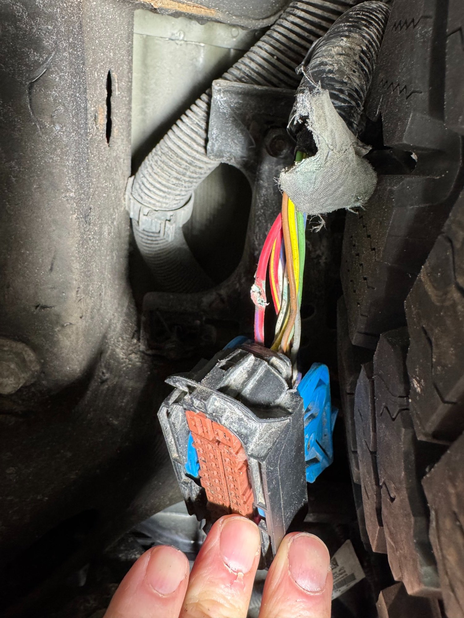

I had the same issues above, tried fuses and even a new trailer control module, nothing worked until I took apart the wiring harness going into the trailer control module and found a shorted and corroded wire. The copper had disintegrated. Spiced and used waterproof butt connectors and now working again without error.
I have 2 wires corroded and need to do the same thing.  Did you cut the entire connector off and resolve everything or just the affected wires?
3 minutes ago, Ntbgmc said:
I have 2 wires corroded and need to do the same thing.  Did you cut the entire connector off and splice everything or just the affected wires?  My corrosion goes right up to the harness
