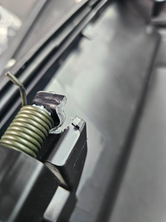

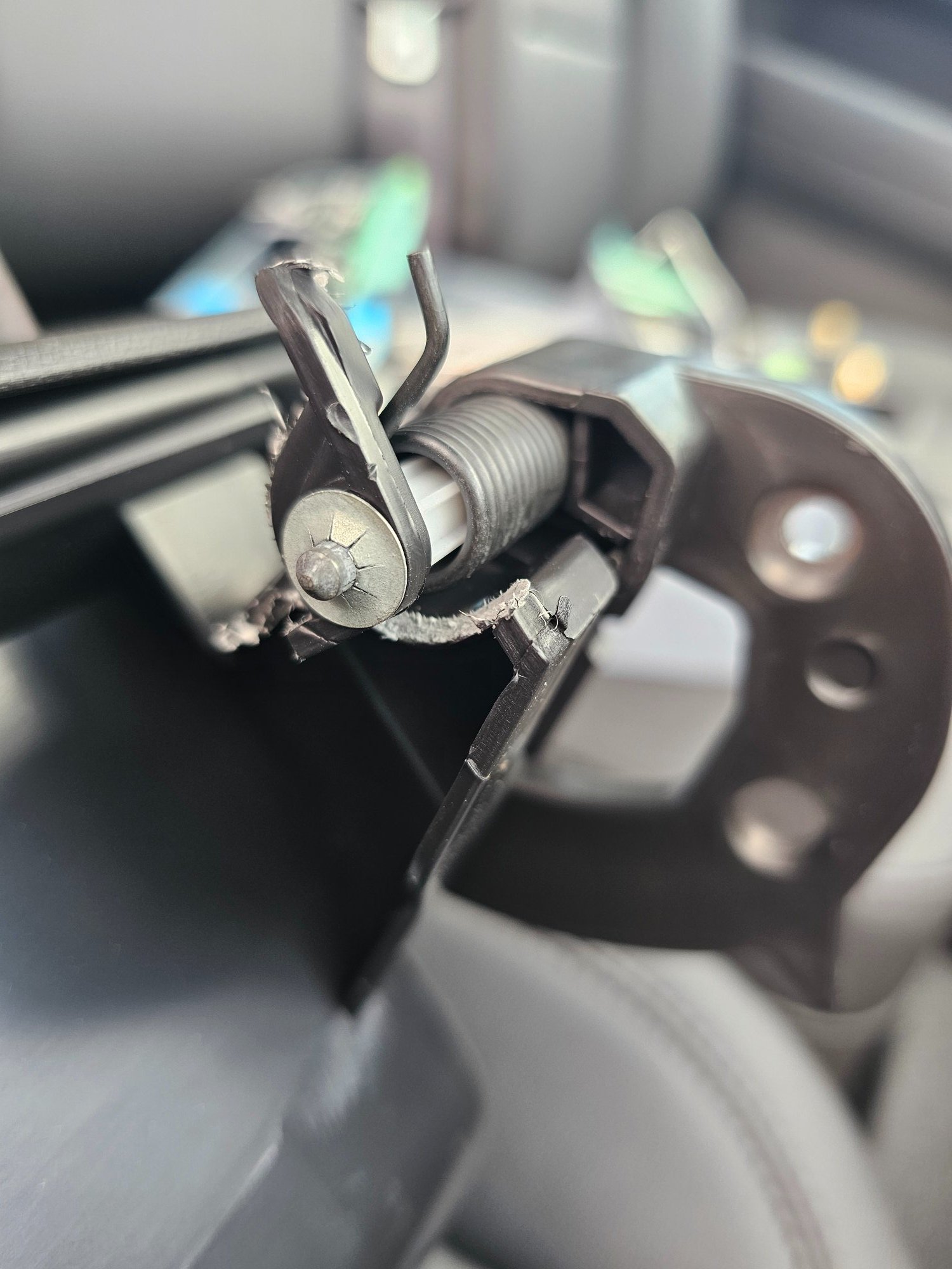

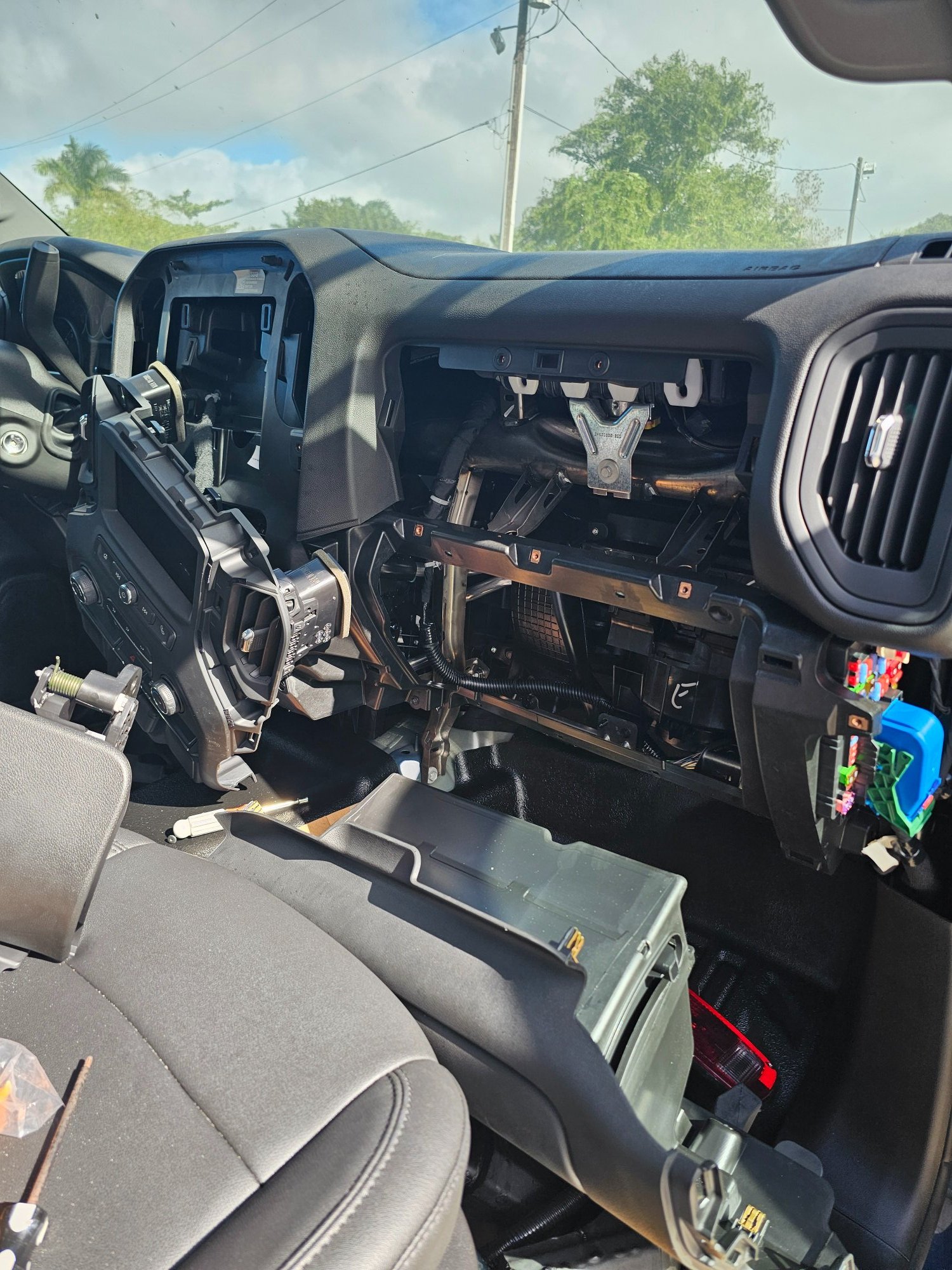

Well I found this on my 2021 3500 u cab and chassis under 5 k miles I bet you will find the same thing on yours
To find out how to get the upper glove box out look up how to Chang the cabin air filter
Wow big job! I just snaked my auxiliary wiring circuits below the dash. Had to remove some module and a bracket and made a slice in the nipple in the upper firewall to run the wires to the underhood fuse block.
I think the problem with these boxes breaking is due to how quickly and sharply they pop open when new.  I use my thumb to open the box and let my fingers keep the box lid from slamming upward. Bad design on their part. They should have built a shock buffer of some sort into the mechanism so that they don't flip up so hard. Don't forget to tell your passenger to slow the opening as well. I have a feeling it wouldn't take more than a few unassisted openings to break, especially in a cold interior.
