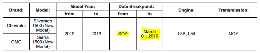

2 hours ago, wahoowad said:
Thanks @New Dude!
Your info about "Here's the bulletin on 8 speed shudder for 2019 - 19-NA-121 1..6 (nhtsa.gov)" matches my issue.
How can I determine if my truck meets this date criteria?
Look for the build date in your driver's door jamb.  Should be printed on one of the silver stickers.
