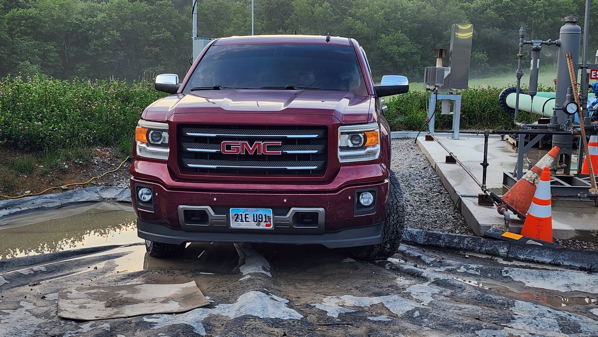

Ok I know the information is somewhere on here but I'm not having any luck with correct wording to find it. I want to put a 2016-18 grille on my 2014 sierra 1500. I want to know what needs changed. After hitting the deer with it everything back to the radiator core support needs changed so I thought I would make the switch to the newer version. Any help would be greatly appreciated.
I believe you basically need the whole front clip.
Grille, headlights, bumper and all that. The 2016 grille is way more than just the grille.
I mean just look at how different they really are.

My bad, but a sierra looks to be the same way. The grille goes lower on the 2018, your bumper will not work.

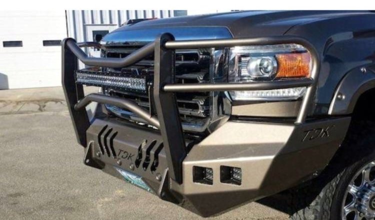

Yes that's correct I need a new bumper. I will be getting this bumper that is made to order

Yes this is exactly what I was looking for. I knew it was here somewhere. Thank you for finding it. Since I'm using the offroad bumper my parts list will be a small one.
