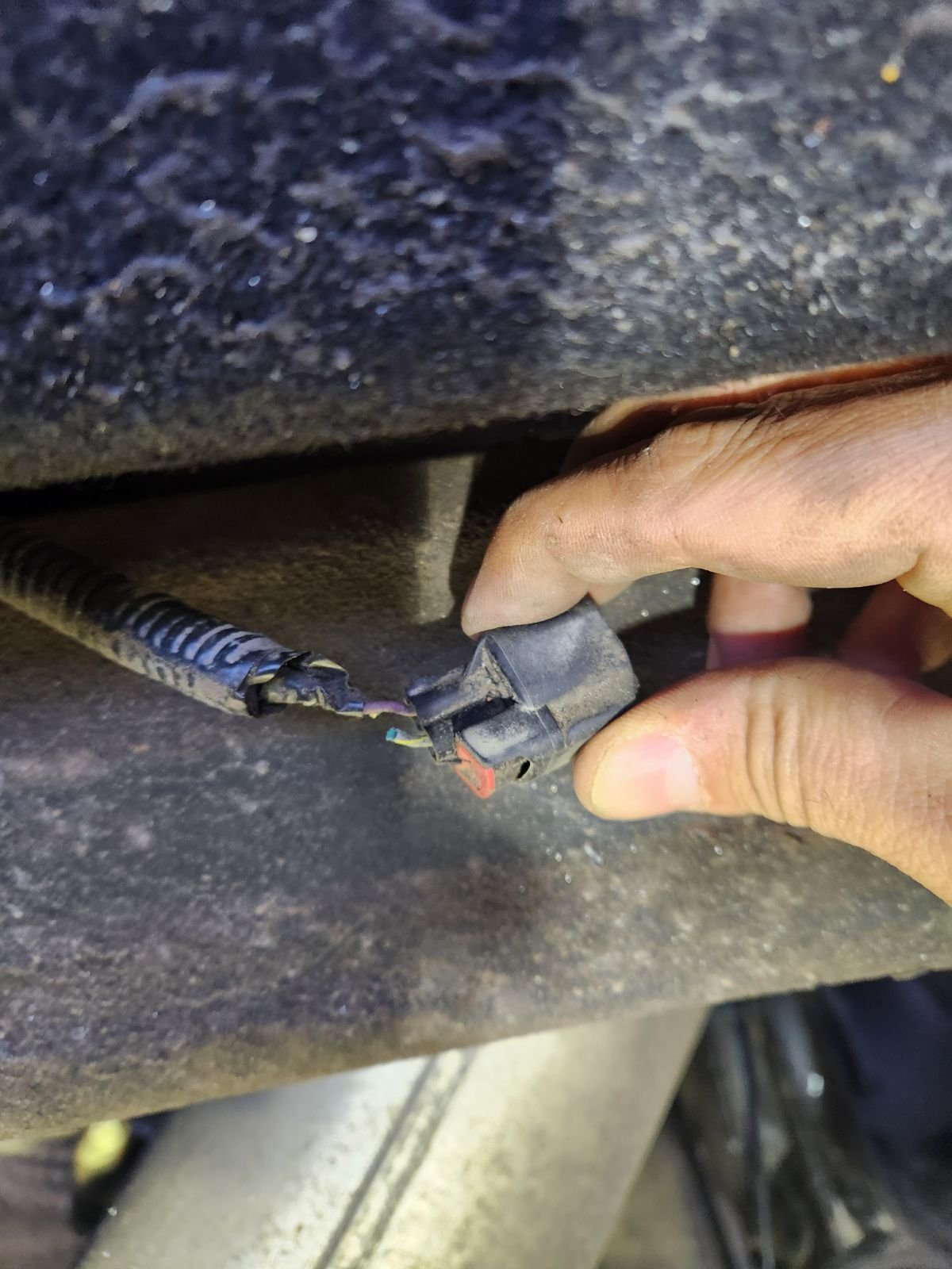

I had these same codes a few months ago after during a roadtrip. Happened instantaneously on the interstate.
I think I drove over some debris that tore a wire harness in the rear.
Look at the wire harness above leaf springs in the rear. See if there's any torn wires and damage. This harness connects to the trailer brake outlet and the ABS sensors, if it's damaged and prevents the signal from transmitting, you get those 3 codes.
I had to replace it with GM 19300543 and all was fixed.
Thanks for the update :)
