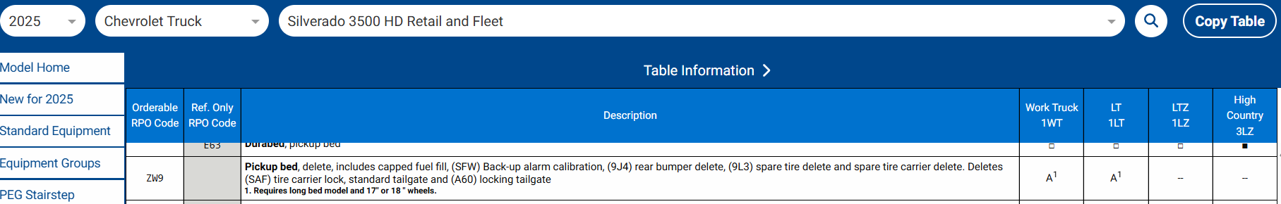

If you order a work truck or an LT you can get it as a factory a 'bed delete'.
On GMC it's available on Pro and SLE

Way back in the seventies we were using born free slide ins that had access to the truck via sliding windows. Nothing special order they came that way. Our campers were large with their own axle. A smaller camper with a 4WD truck should handle off roading without a whole lot of modifications. You’re not going to gain much without a bed. You’re going to have to make a flat surface for the camper that will be the same height as a regular bed.

E001D35F-9ECF-442A-865C-09947D2C101A.jpegaaad
It's available on the GMC Pro and SLE trims.
