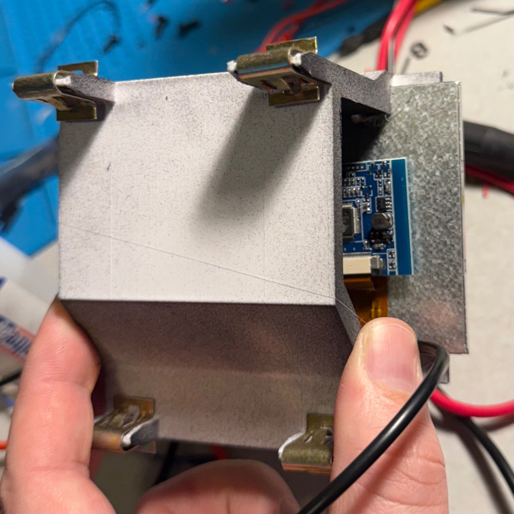

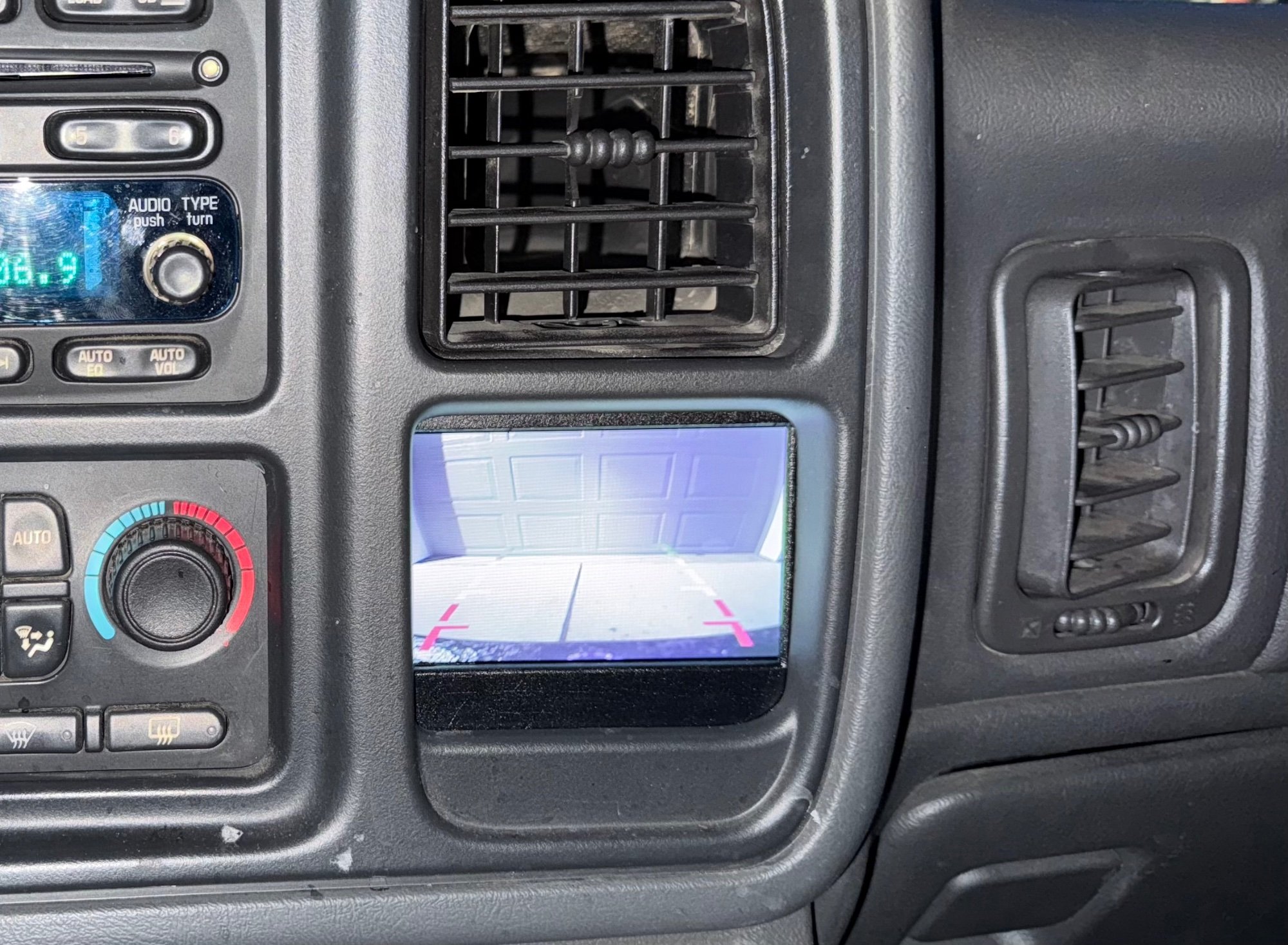

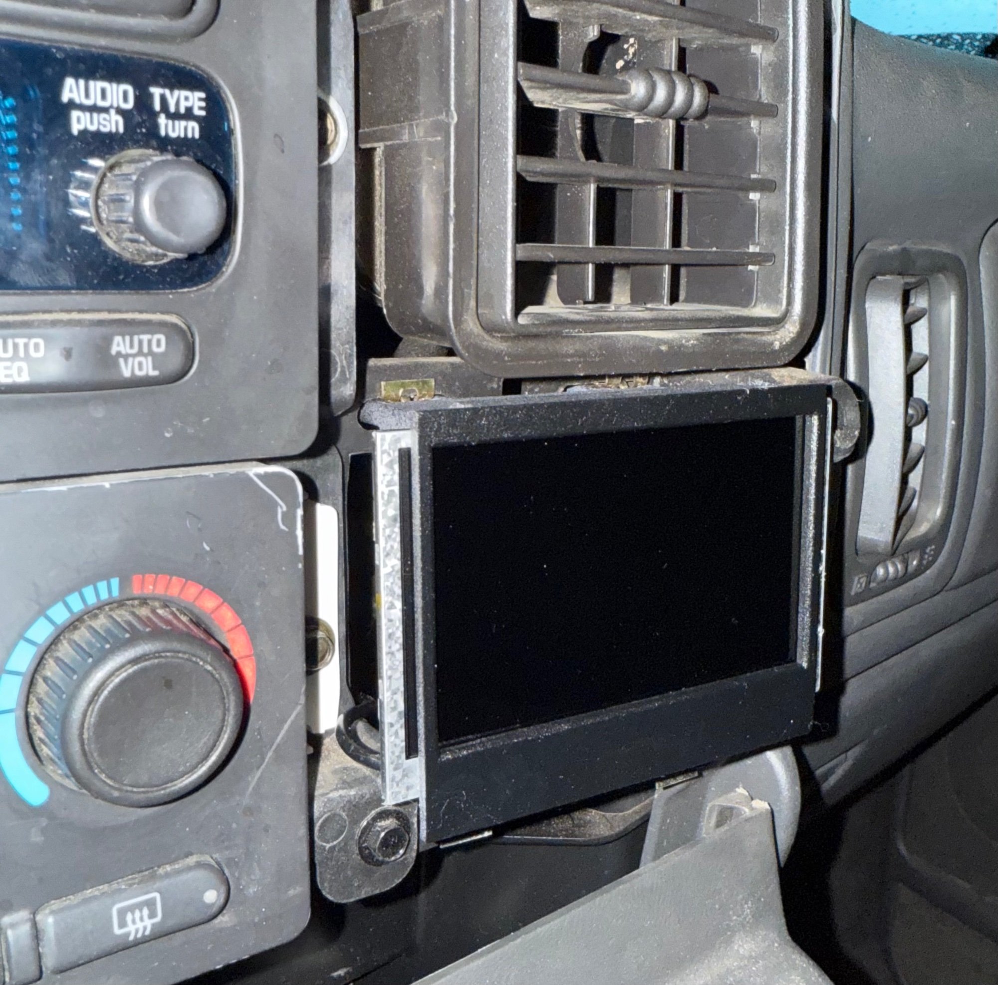

I believe this has been done before - but I wanted to share this as an option for those who want to keep the stock stereo.
I printed a bezel/mount out of PETG that snaps in replacing the airbag switch and blanks.  It houses a cheap 4.3" TFT screen.
