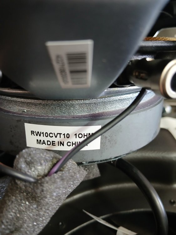

Any issue running the same sub woofer ( sticker on woofer shows 1 ohm) and the enclosue with a different amp  if run larger power wire to the new amp from the battery.  Plan on using the same line outputs the kicker kit used. (Yellow and yellow with stripe up by the pass front door kicker panel.  That's where the kicker kit connected.

As long as the amp is 1 ohm stable, you should be fine. That surprises me a little that sub is 1 ohm.
Looks like it's dual 1 ohm, so maybe it's wired series to 2?

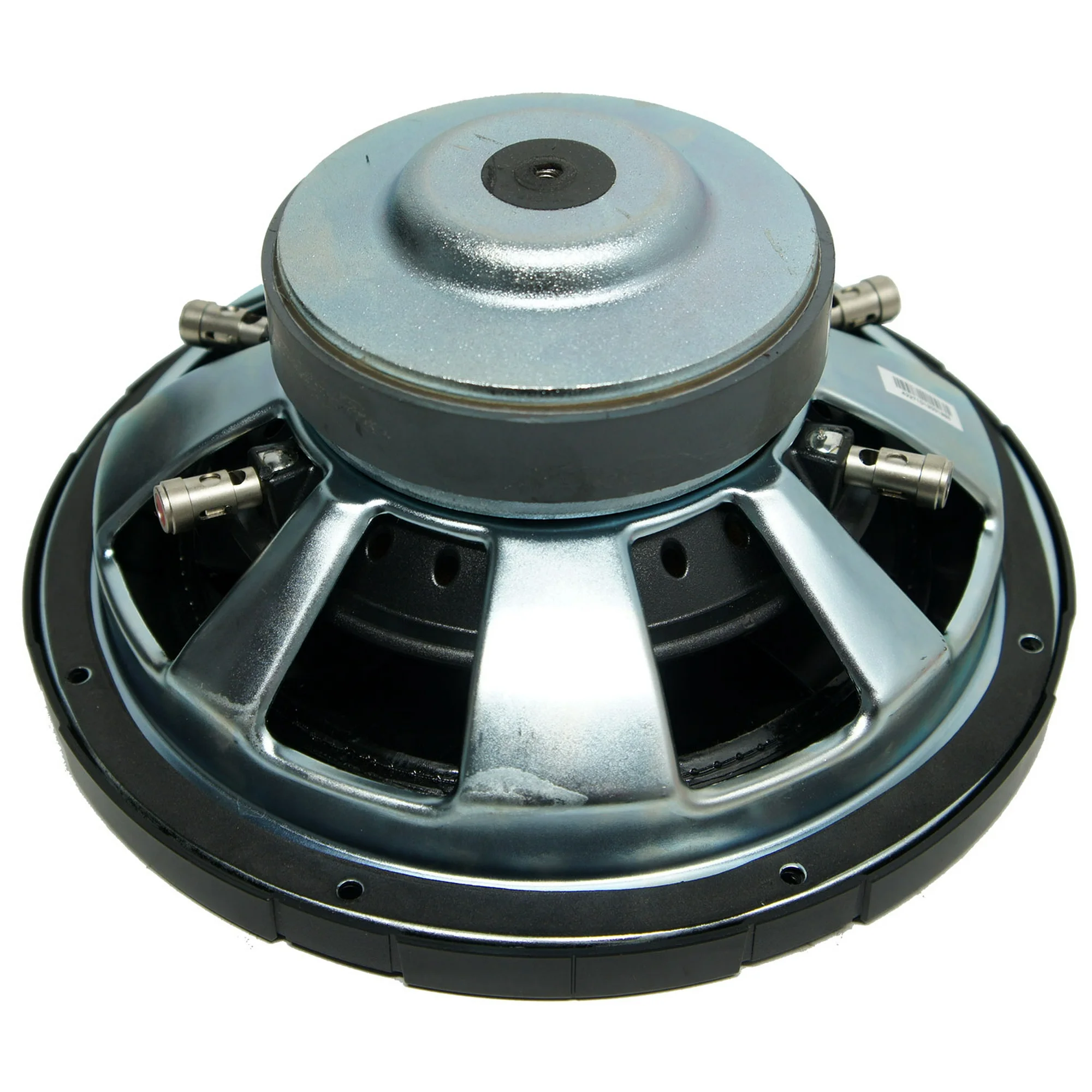

I do see Kicker amps (such as 42PXA2002) list as 1 ohm stable, so maybe they were doing 1 coil per channel. You could wire them in series to increase your options with mono amps. The sub looks like this?
