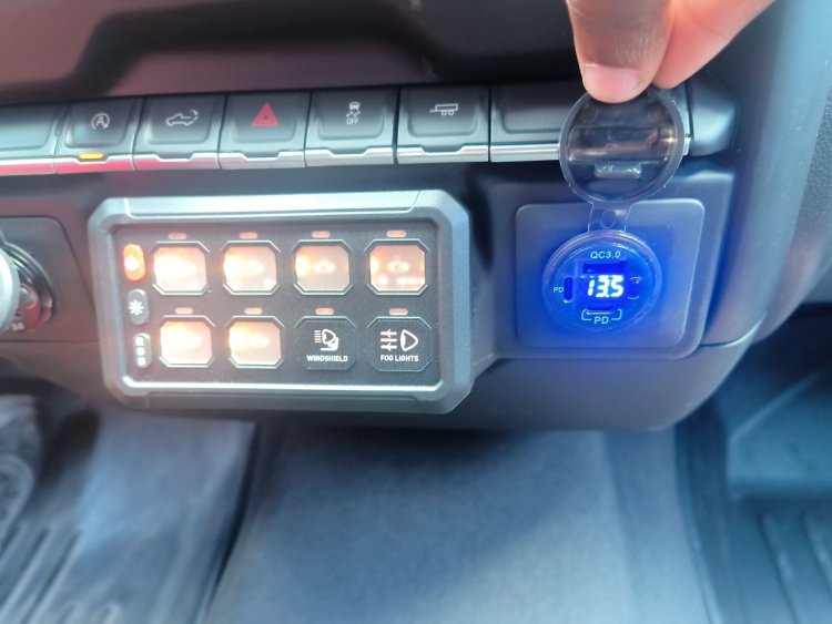

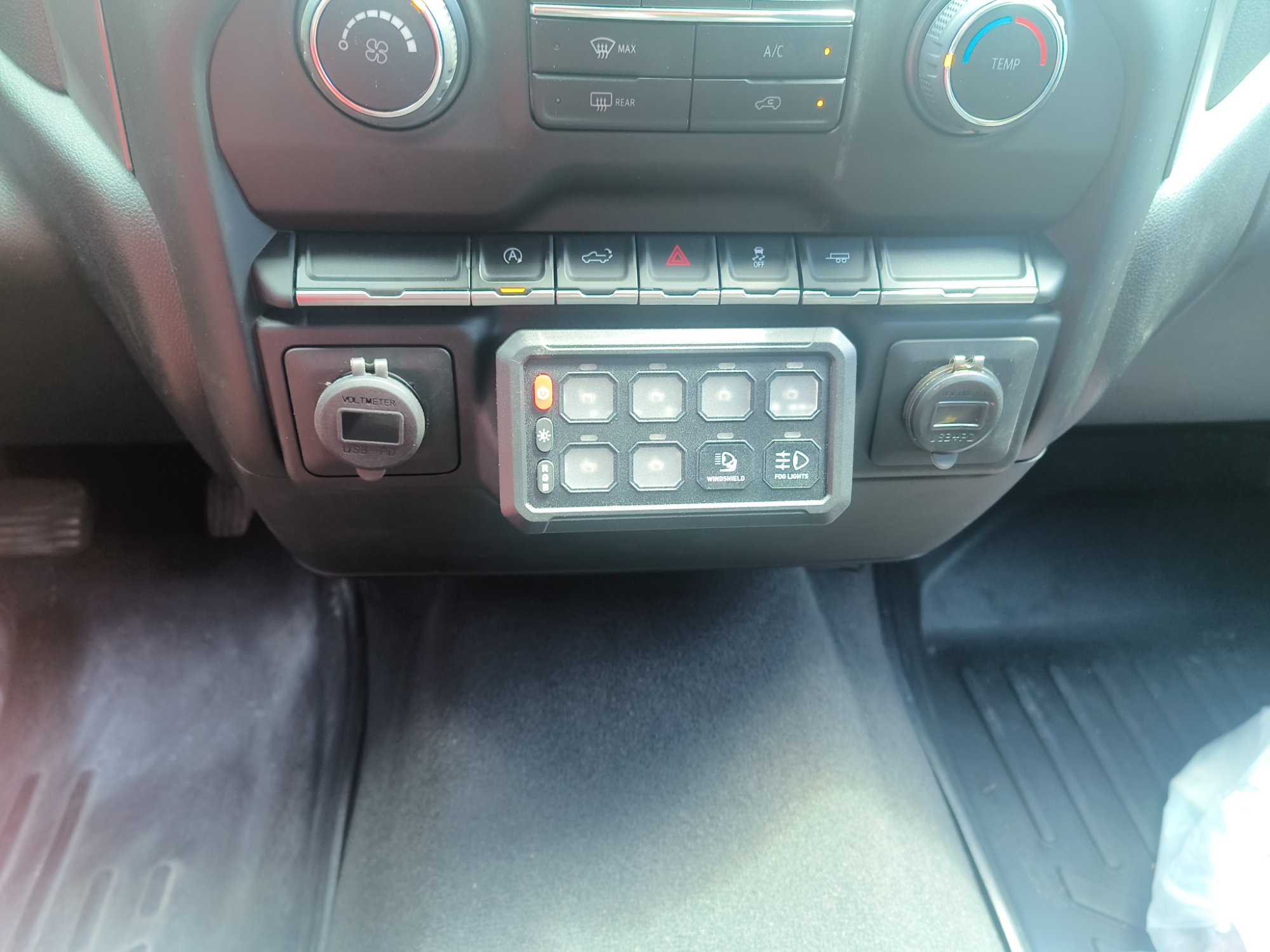

Relocated the factory USB to the glove box. Added in 8 -gang switch panel and two fast chargers where the blanks used to be.
Well, as I have a custom, I didn't get the factory fog lights. The aftermarket lights I put on needed a switch. I also added some ditch lights to the hood. Plan on putting a stubby front bumper with 20 in light bar up front. Aux reverse lights on a custom bracket I'm working on. Bed inverter. I want to put a hidden compressor somewhere as well. So, I opted for the 8 switch panel for future upgrades.

Is that switch panel from Temu? I’m considering getting one. Are you able to demonstrate the strobe features of that panel? If so, does it just have 1 flash pattern or are there a few to select from?
 No, not from temu. Can't tell from the picture but the brand is Mic Tuning 8 Gang P1S RGB panel. Can be found here
https://a.co/d/82Ps3eb
It has the regular on/off function, momentary, and strobe. I will take a quick video for you when it gets dark out tonight.
Yes, they are separate. I took power from the factory 12v outlet harness and used a splitter to feed the chargers. You could however have them switched from the panel. I just didn't feel like running additional wiring into the cab through the firewall to make it work. They do have their own dedicated on/off switch on the face of the charger.
Edited by BlackJack997
That would be great! I’m curious if there are multiple strobe patterns, or just the one
From what I have seen, just the one. They may have newer models that have variable strobe, idk. I saw there are Bluetooth remote versions with app capabilities so who knows....
