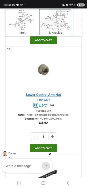

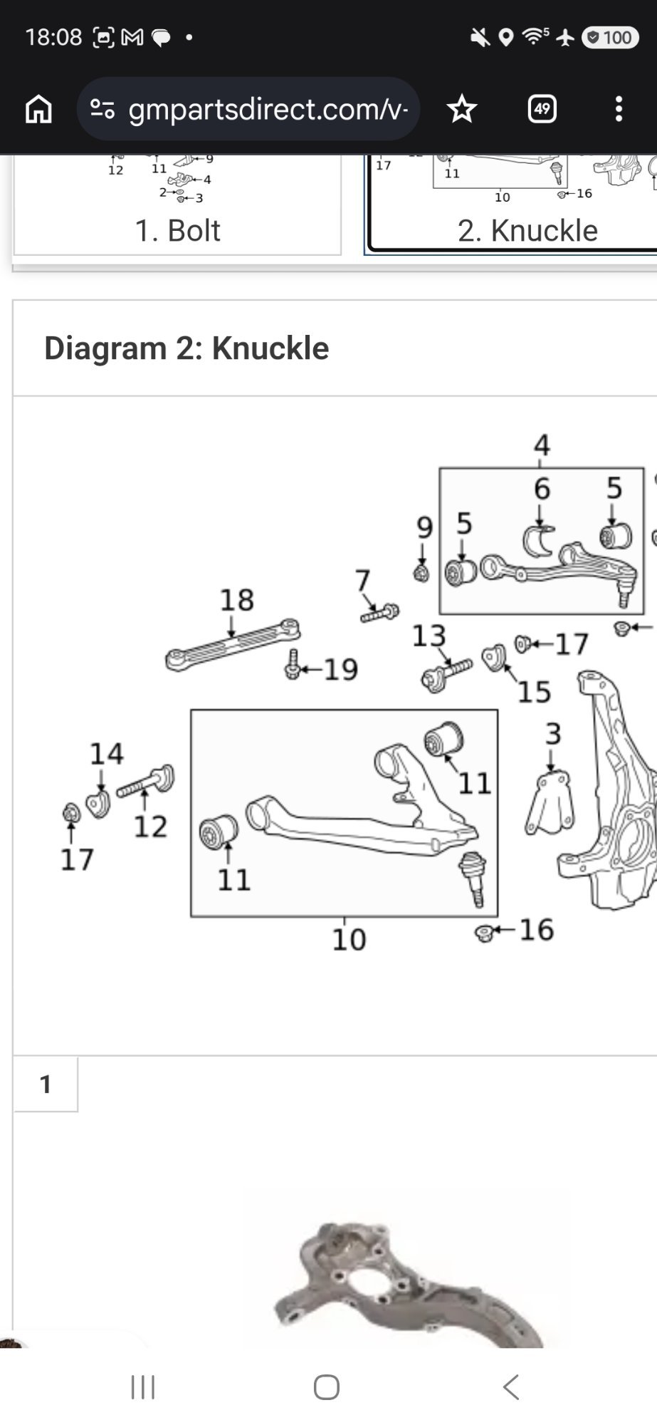

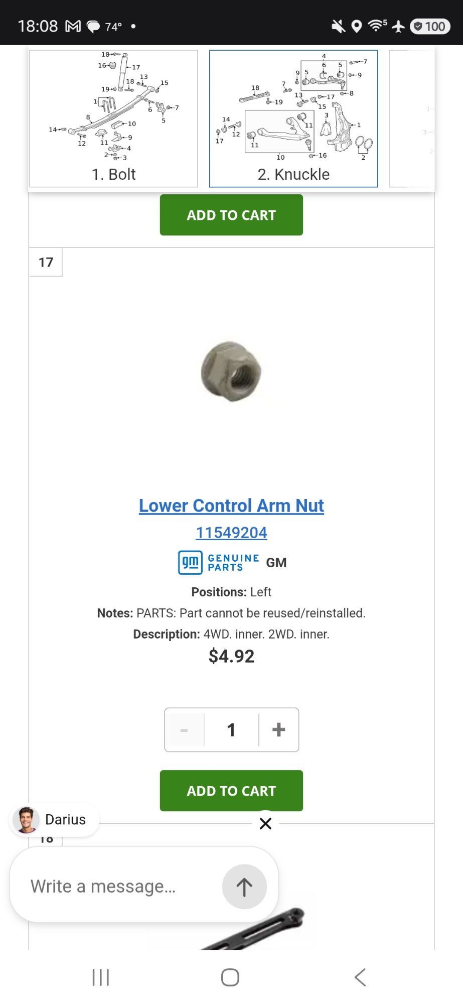

I really appreciate the response.  I guess I was confused about torque angle vs torque angle yield.  The individual bolts don't have a warning on reuse but the part number for the LCA nuts does.
Regarding the purpose of the moog grease fittings on their bolts .. Guessing to reduce possibility of corrosion locking the cams or seizing to the bushing inserts.
I would argue that GMPartsDirect has that info wrong.
The service manual for R+R the lower arm and for adjusting camber/caster, none of the steps say to discard and replace the nut or the bolt.
The only part that gets discarded is the plastic cam adjustment retainer that is in the eccentric from the factory.
The LCA nut torque spec is:
First Pass: 180 Y (133 lb ft)
Final Pass: 90 –105 Degrees
That is WELL past 130ft.lbs per the TSB that you reference that does not apply to this scenario.
As for your clunk.  I'd say it needs to be diagnosed thoroughly.  Assuming the LCA hardware is tight, you could have a problem with the UCA, sway bar end links, etc.
Thanks again man.  I haven't had an issue since the local shop torqued everything down but it's def on my radar.   I made an assumption that torque  angle = torque angle yield and with the info from gm parts direct went down a rabbit hole.  Really appreciate it.
