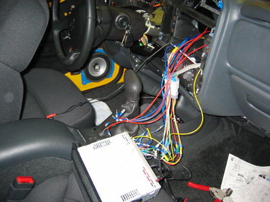

I have the Metra kit for the double-DIN opening in my '04 Blazer. Here's what it looks like:
The RCA jacks are for the auxiliary input (portable MP3 player or whatever other toy I want to hear). They're bolted to the "pocket" so there's no fooling with patch cords in the dash area - just plug and play. An advantage to this type of kit is that it puts the head unit up high enough that the bracket thingie inside the dash (stabilizes the back of the stock radio) doesn't get in the way of the harness and wires coming out of the head unit. With certain kits you have to cut off the bracket to get aftermarket units to fit. And when you're cramming in this many wires....
....you want all the space you can find!
