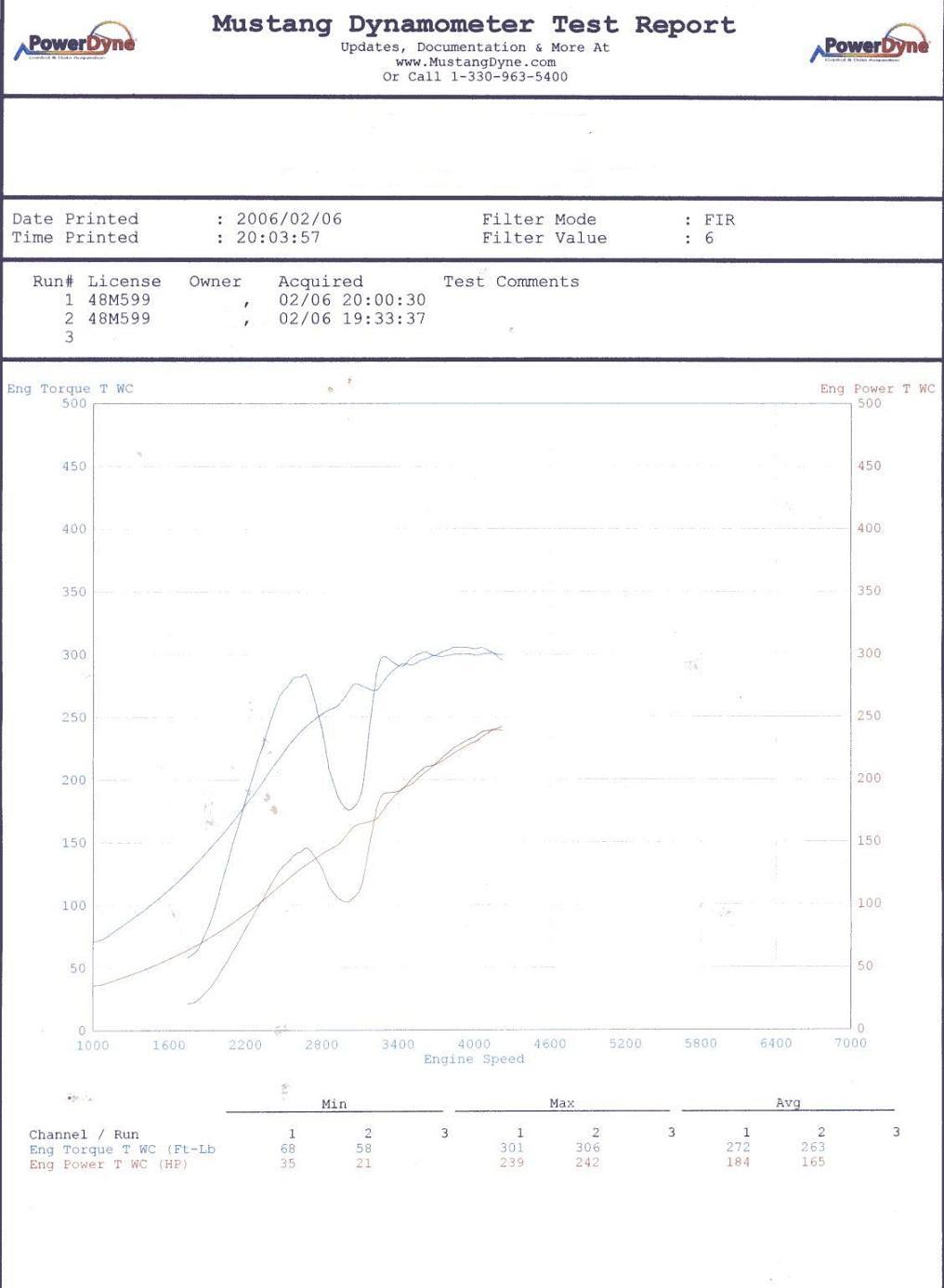

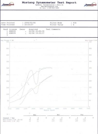

I cant see how these numbers are correct. I would have thought this truck would do way better than this. This was a brand new dyno they had installed on Wednesday last week. Had a few other cars in there that seemed to have dyno'ed fine. Just wondering if they set my truck up wrong before the pull or something. Anyone with dyno experience, i would appreciate opinions here. He looked my truck up and found only one engine for the 2500HD on his list which showed him 50hp@21MPH or vise versa, i cant really remember now. Im just not on the up and up about how to setup for a dyno run, I was counting on them to have all the data correct. This truck just feels so much stronger than what this dyno portrays. Anyway here is the graph, take a look at why I am disapointed..........

Correct Linda, the Ally is controlled by it's own computer and has it's own torque management. The PCM has no control over this, but the tune does eliminate all the ABUSE management. Those numbers are about 50 hp/50 ft lbs down from other trucks setup like yours. I think it just comes down to a new dyno/new operator. If you need to see different numbers, try another dyno.
Im wonderin the same thing Butch. Can you give me any insight as to what they could have done as far as setting up this dyno that would give me inaccurate numbers. I really liked these guys, they seemed very nice and wanted to work with me, im just worried they may not be as experienced as they need to be to get done what i want to get done. Not to mention they were giving me great deals on the dyno pulls and dyno tune when i need it.
There's probably some calibration for the Dyno that isn't quite right yet. It needs a comparison with another dyno to be sure. Trouble with dyno's is everyone puts out different numbers, big variation between dyno brands too.
