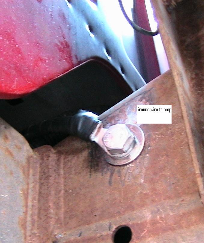

i have only one amp, but its grounded to the studs for the seat frame w/ an o-ring crimp connector.

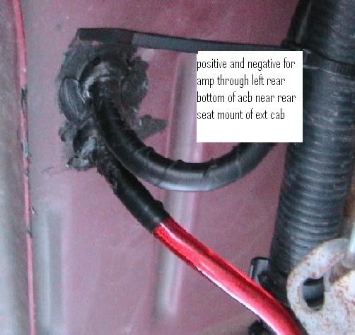

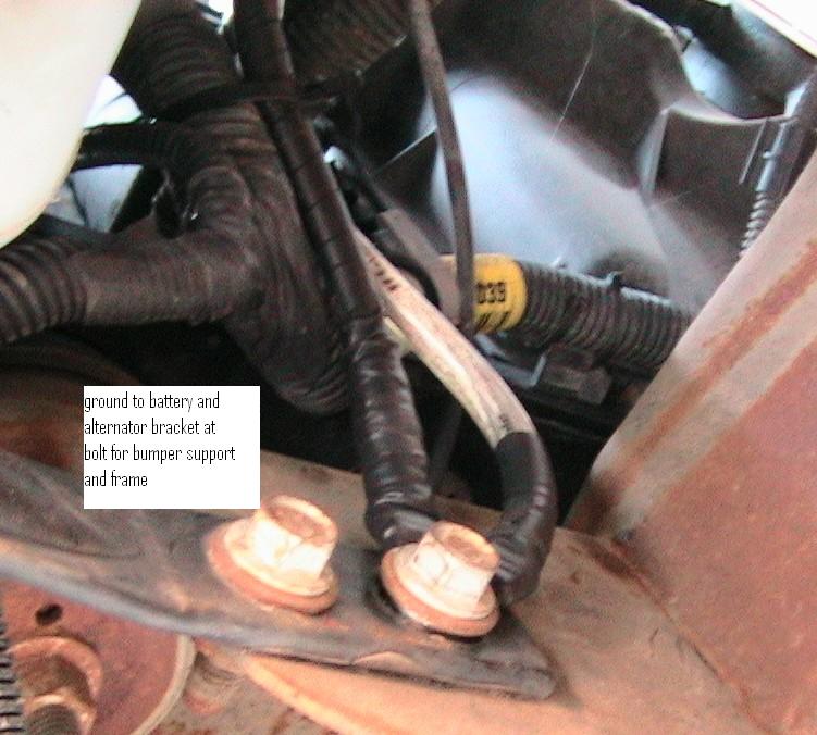

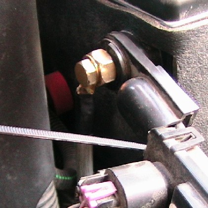

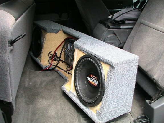

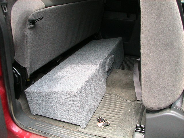

I only have one amp, but this is how I done it. I drilled through the cab and bolted directly to the frame. I also run a ground from the negative battery terminal and the alternator bracket to the frame to complete the circuit. I then upgraded to alternator wire. I also connected my power wire for the amp where the alternator and positive battery wires meet up. I didn’t feel that there was enough room for the bigger battery post on the positive. All wiring was done with 4AWG, cause I’m only running one 400watt amp. Here are some pics. I hope this all helps.
