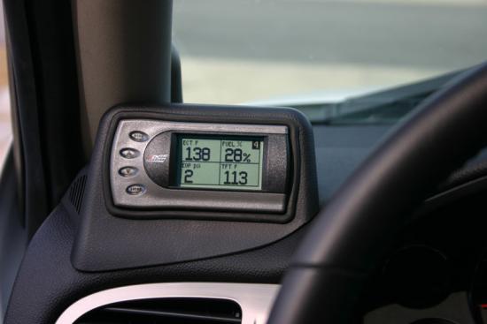

After reading their explanation about TM, sounds like you need to be an engineer to figure it out! I sure hope it's clearer than that when you loading the tune! After reading VMax's post on future updates to the Edge, I think I'll stick with it and see what happens, besides, can the Diablo Sport do this:

At this time, the only customizable parameters on the Edge are changes in top speed limiter, and changes for tires and gears. I have no idea if the rev limiter has been adjusted in any of the "canned" tunes as I've never tried to rev it that high.
