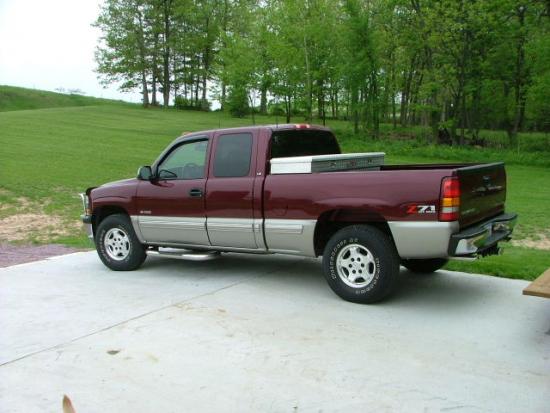

I have a issue with my 2001 Chevy 1500 pickup with a 5.3
The battery icon in the message center will flicker constantly after the truck is started. The voltage is good. It runs about 13.8 to 14.0 volts at the battery. The volt gauge don't change when the battery icon illuminates. Someone told me that maybe the dash cluster needs attention. Don't know what that means. It only has 34600 miles on it. For low mileage this truck sure gives me problems. I also have a code P0455 which I know what to do with. Any help would be nice. Thanks
