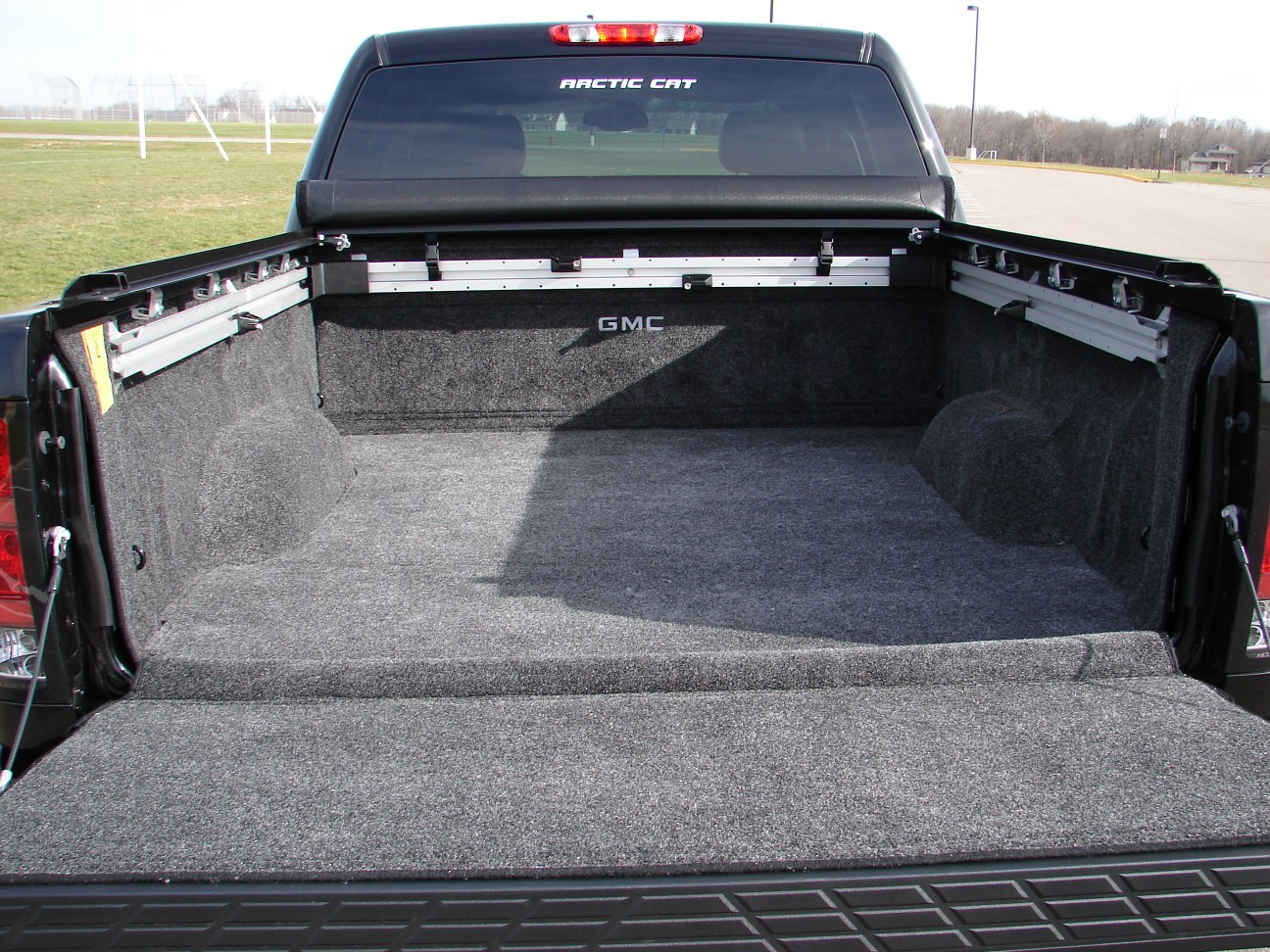

Here's my CMS with a Access Cover...

Riki, Does your Bedrug get wet near the tailgate? My Access cover/tailgate let's water in during heavy rain or car washes. Doesn't matter to me since I have the Line-X and no Bedrug. I was just curious. I know they make a tailgate seal, do you have that?
No clue if it gets wet as I've only washed it once since the install and it hasn't been rained on yet but I'd say no since I did buy the "Limited Edition" Access cover because it came with a tailgate seal.
On my last truck w/ Access cover, the bed would be full of dust when driving on a gravel road so I'm hoping the seal helps with that.
