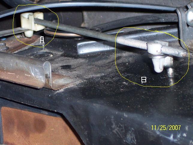

Here are pics of the rod and connection in ?.The connection at circle B is what I'm working with.I have played with the timing of both doors and have them close.I would just like to have the correct information on adjustment(timing).There is no way its just a get it close and go situation.There has to be something in print.Some where.
