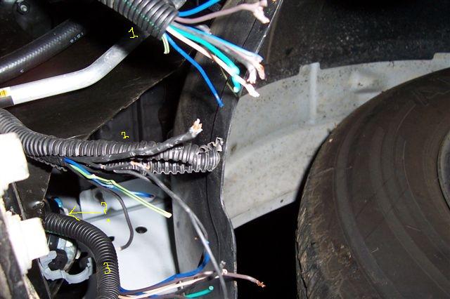

Help, my friend's brand new '07 Silverado had some damage done by rats chewing the wiring. They chewed some wiring under the passenger side wheel well near the radiator. There are 3 conduits coming together at that point. There are 2 big black wires, probably for fans or lights, there are also several blue wires coming out of each conduit, and a green. I don't know what blue wire to hook to what blue wire. He took it to the shop and said it wasn't warranty and he could be looking at $4000 to repair. :D That's crazy! I can't find a schematic for it and not sure if one would help due to several wires the same color(blue) . Can anyone please help? Maybe you could look at your wiring and tell me what wire goes to what wire in which conduit. I also have taken pictures and will try to upload.

Yeah, they already told him it's not warranty. He doesn't want to have file on insurance because of the deductible and especially since it's something so simple for me to repair for him. They are chewed clean in two. I have plent of wire to make a good clean splice. But why do they have multiple wires of the same color? :D
I took pictures last night, but I don't know how to make them less than 300k because I took them in high resolution.
Ok See if this works. Harnesses are labeled 1, 2 and 3. Also what is this thing with the ? next to it. I almost thought it was a horn, but could it be a crash sensor?
Please excuse me if I sound flippant, but try putting the same color wires together! It looks to me like all the wires are "color coded". Look close and look to see if there is a stripe. Get a splice kit and a pair of wire strippers and put them together. Don't forget to re-wrap the bundels.

A similar thing happened to a friend of mine in his Yukon. Dealer wanted something like five grand to fix it. Since all of the harness wires are color coded, we peeled back the crinkle housing around the harness and started replacing wire sections using solder and heatshrink tubing. We patched about 75 frikkin wires in one weekend. Once we had everything buttoned up, it started up and ran another couple of years without issue until he traded it in.
If you exercise patience and solder every connection, heatshrink it, and use good 3M electrical tape, the repair should be as good as it was new. It's a pain in the ___ but it saves a few thousand dollars!
