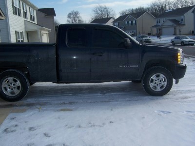

y2kz71 Posted January 23, 2008 Posted January 23, 2008 Mine with the 2.5" kit and no rear block (mine sat 4" higher in rear from factory)

thunder219 Posted January 24, 2008 Posted January 24, 2008 I ordered the 2" kit but thats not to say they sent the wrong one. My truck doesnt look like it sets as high as the one in the above pic. On cutting off the studs I just put it all together and then cut it while it was out of the truck.
