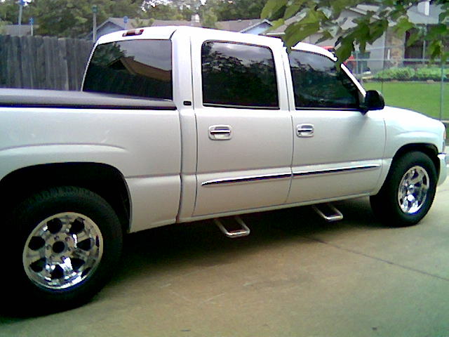

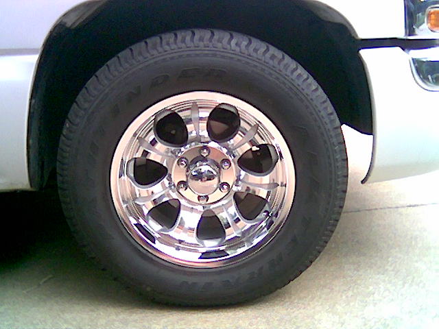

I'v had 285s on both my 99 RCSB and my 00 ECSB with no TB crank and no rub what-so-ever!
Your truck looks awesome!! thanks for the reply.
