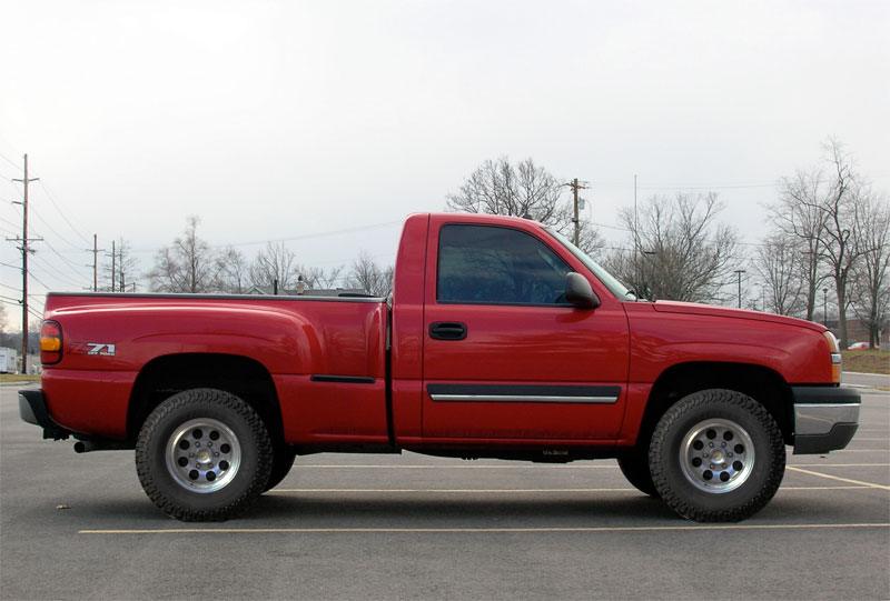

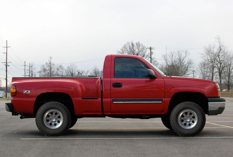

I'm thinking about getting new wheels when I have to get new tires and I like the Mickey Thompson Classic II design. I decided to do some Photoshop work and see what they'd look like on my truck with some larger diameter tires and here are the results. The first shot shows the truck as it is now, the second shows the new wheels and tires without leveling the truck, and the third shows the leveled truck with new wheels / tires. I think I'd like to keep the 16" diameter wheel but I'd like to get a wider wheel than stock if it will fit. I'm not sure how wide it will go but I was thinking about 10". Take a look and let me know what you think is possible with my truck. It's an 04 Z71 by the way. I'd appreciate any opinions / suggestions you have.
Thanks
Looks pretty good with the wheels and level. 16x10s will rub like a big dog when turning running 265-75-16s. Personally I'd run 16x8s with 265-75-16 (or 285-75-16)...

From what I understand the truck comes with 16x8 OEM right? I was considering the 285-75-16s on 16x8 but was wondering if there's anything bigger that would fit but without having to put on a lift kit. Thanks for the comments.

The factory wheel you have on there is actually closer to a 16x7 if you measure it. Aftermarket 16x8s will be almost a full inch wider. 285s are about the biggest I've seen without lift. (that don't rub a lot) A 16x10 wheel will stick out a lot... good luck!
