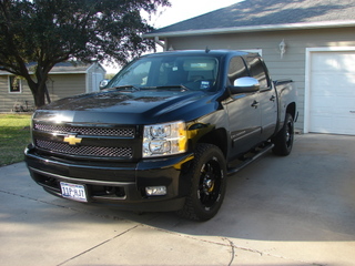

Looking to see if anyone has one of those GM paint grilles with the chrome inserts? Looking for a chevy 07 and up NBS Silverado with it on... Was thinking of buying it, but wanted to make sure how it looked and how easy it was to install myself...Thanks.
this is exactly what i needed..thanks for the pics... Did you do the install or had someone do it?
I believe all Maxs came with the color matched front ends, I love them like that!
Here is a photo of mine...still haven't taken any better ones since putting the level kit on it...I also put a red overlay on the bowtie....I don't really like the overlay so I am looking for something else....also waiting on the rear fender liners...ordered them last week and they go lost somewhere along the way :uhoh:
