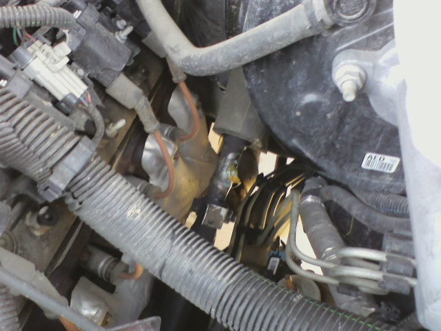

ill tell you exactly what I did.
I used a plumbing clamp( as suggested on this site) around the pipe where the white/green bushing is pressed in to where whole steering shaft runs through that is underneath the dash.
look that up, youll find it here.
2 Opposite of what a GM tech said on here, I drilled and tapped a grease zerk into the lower end of the steering shaft under the hood. Ill grease it every 3-5K miles when I get a service.
CLUNK GONE.

Yes, it is really no big deal but there is one very important thing. You cannot let the steering wheel spin while the shaft is unhooked> You have to have a way to hold the wheel in place. There is a tool for this but a ratchet strap hooked under the seat and to the wheel will do fine. Just do not let that wheel turn while the shaft is out. It can and likely will mess up the clock spring in the steering column.
Which shaft would you install? Borgeson, Dorman or GM?
Is this the part causing the problem?
The Borgeson looks beefier, but is it worth the extra money?
Are any of them a permanent fix?
