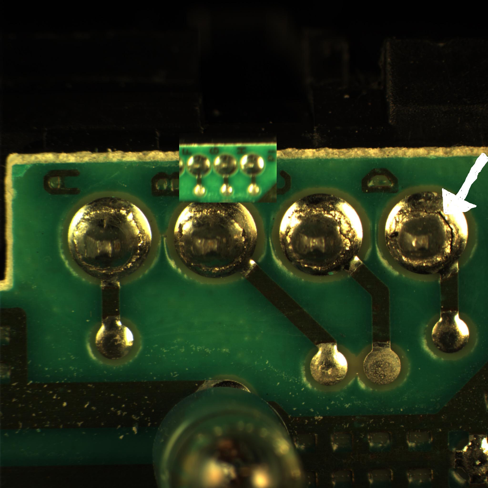

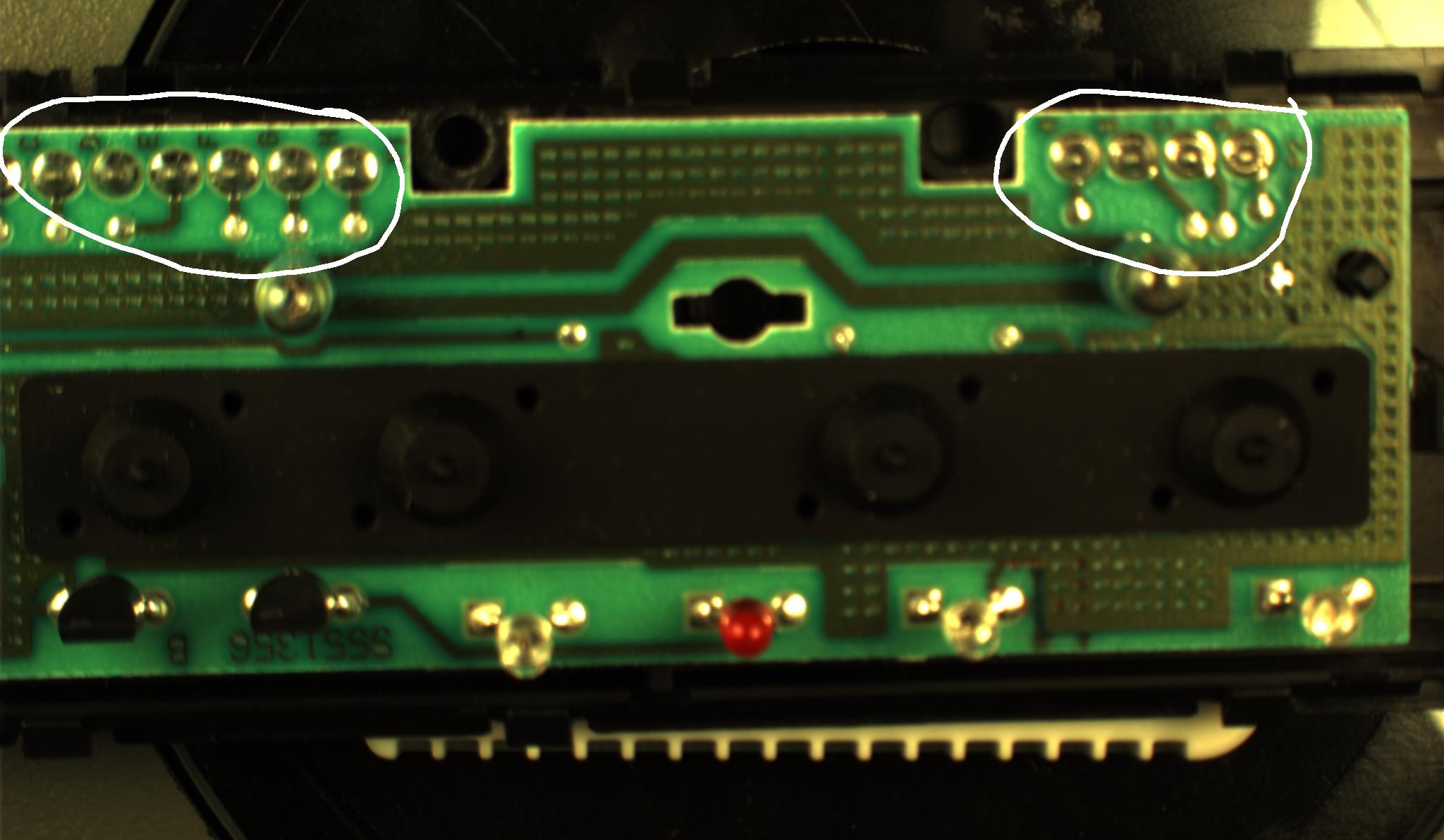

I repaired mine, takes about 2 mins to pull it out of the dash, remove the switch box, disconnect the 2 connectors, pull the back cover off and you'll see the solder pins, just use a solder iron to "reflow" the solder. Mine had visible cracks, put a dab of solder flux, may need solder, touched it with a solder iron 500-600F...and walla, about 20mins of my time and its fixed.
This is what it looks like once you have it out and the back cover off, there is two rows of solderpins, if yours is bad, you'll see cracks in the solder around the pins. Yousimply just "reflow" or melt the solder for a good connection. The solder is cracking over time for some reason, thats the problem, creating a high resistance circuit or open circuit condition which triggers the "Service 4x4" light.
There are lots of articles on this repair on the internet. The last poster hit the nail on the head. My old 99 Silverado had this problem. Re-flowed the solder joints and drove it for 5 years until i sold it with no more problems. Cost to fix? $0 Zero Dollars! About 20 minutes including disassembly, repair and re-install. Simple fix!
Exactly what I did. I have some minor soldering skills and this was a 4 on a scale of 1-10.
