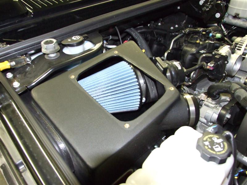

Does your PowerCore filter angle towards the fender hole? Mine doesn't, doesn't look like the the great one-page installation doc. Seems like it's got the wrong filter box adapter or something. Maybe this is normal?
See this picture, how the filter is slightly angled toward the fender hole, mine doesn't angle, it's even with the top and is even going to touch the lid once I put it on.
I had to rotate the filter to get it in the right position, but yes it is angled a bit.
