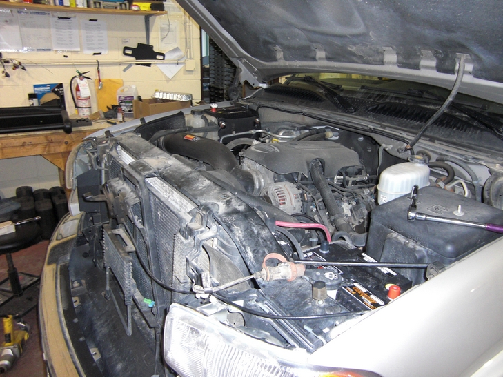

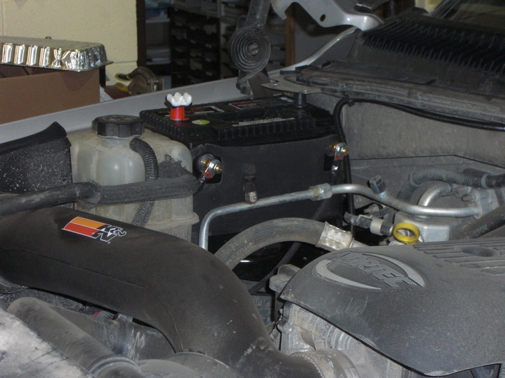

My 99 GMC 2500 has factory dual batteries. The second battery is located by the firewall on the passenger side. Close to the ac lines. I will snap a pic and post tonight.
I bought the aux battery plate and mounting stuff from GM and installed a second battery on my truck.
Wired up an ign triggered high current continous duty solenoid. it works good.
That looks sweet.. what did u need the 2nd battery for? and how much did it cost?
I only use the truck in spurts and sometimes it sits for 30 too 90 days untouched.
even after 30 days i would go too start it and not even get a click.
I don't have onstar, so I couldn't blame that for killin the battery. and i was getting really annoyed over it.
I called GM and they said that the truck should be able too sit for 30 days and start up no problem.
I have the battery tested and it was a bit weak but it should have been ok according too the battery place.
I was fed up especially since alot of times the truck is parked out in the bush and I hate walking back too civilization.
So i paid the generals price for the second battery plate and mounting stuff, bought 2 new high cranking amp batteries and a 600 amp continuous duty solenoid and wired it all up. when the truck is shut off the second battery has no connection too the truck at all.
if the primary battery happens too die i have a over ride switch in the cab that is powered by the second battery too trigger the solenoid essentially giving myself a boost from the spare battery without having too get out of the truck.
Some day i have too hook up an amp meter to the primary battery and start pullin fuses too see where the draw is and if there is anything I can do about it.
with 2 new batteries the mounting plate and stuff and the solenoid it was around 400 bucks, I used 4 gauge wire too connect the two batteries.
