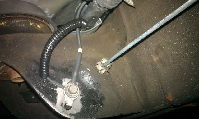

HELP! 2010 Chevy Silverado 1500 LT 4X4
First post. Just installed the "1 x Silverado 1500 Fog Lamps, Clear Lens, 24 Watt, Black (41U) (19170441)" kit from ShopChevyParts.com. I tested the entire circuit with a multimeter and everything seems fine, however when i turn on the fog lamp switch the marker lights and the green light in the cluster comes on but not the fog lamps. I called the dealer and they said the computer needs flashed. Any suggestions?
Nowhere in the instructions does it say to flash the module. I would guess there is a ground that needs some attention. Where did you attach the fog lamp harness to the frame?
Rolling...thanks for the quick response, the ground is attached to the frame in the same spot the the chassis ground is located; right below the
