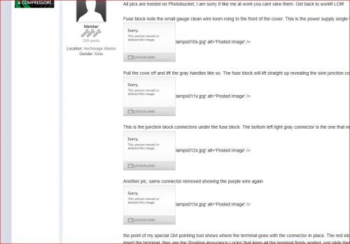

Here are the pics I promised of the wires at the fuse block for the fog lamp kit on the GMT900 Silverado
All pics are hosted on Photobucket, I am sorry if like me at work you cant view them. Get back to work!! LOl!!
Fuse block note the small gauge clean wire loom roing to the front of the cover. This is the power supply single wire for the foglamps
Pull the cove off and lift the gray handles like so. The fuse block will lift straight up revealing the wire junction connectors beneath
This is the junction block connectors under the fuse block. The bottom left light gray connector is the one that needs pulled. The single purple wire is the power wire
Another pic, same connector removed showing the purple wire again
the point of my special GM pointing tool shows where the terminal goes with the connector in place. The red slides on the side of the connector need to be removed before you insert the terminal. they are the 'Position Assurance Locks' that keep all the terminal firmly seated. just slide them out the side of the connector with a small flat screwdriver or pick.
Once installed, they look and perform exactly like trucks that have them equipped from the factory. For color comparison, my low beams are PIAA bulbs now, the fogs have the stock bulb. Its not a normal bulb, it looks more like an Osram style bulb. It puts out quite a bit of light. focal pattern is good for stock lamps, you can see how close to the truck it lights up.
The power wire just needs to be run to the accessories and grounded. Once done, the fog lamp switch will automatically power the circuit, no programming required. As an added bonus, the fog lamp indicator on the dash will come on too. Let me know if anyone needs more pics or if I can answer any more questions!
self quoted, for some reason the original pic links quit working. But in the quote they come up just fine.......... I dunno..
For those that are still looking for help wiring fog lamps in, hope this still helps!!!

MMM....this is all I get. Like he removed them from photobucket......and disappeared :noway:
