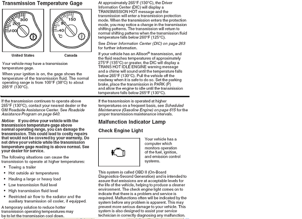

I did some research. And it seems that a lot of guys are afraid of trans. temps above 200deg. So was I. This is from the manual which by the way if you register your truck at mygmlink.com you can get the electronic copy of the owners manual, which is searchable. Once you open the .pdf file hit Control-F and enter the search you want.
By the manual, now I feel comfortable with what I have questions about. These newer trucks may be able to withstand a little higher temperature than past trucks. If not, it is all electronically recorded and under warranty.

This is in the owners manual for a GMT900? I have a feeling it isn't since I don't have an actual gauge for trans temp. I don't like the idea of having trans get anywhere near 265. As the max temp out of the trans to the cooler should be 300, if the temperature at the sender unit is 265, your output from the trans to cooler will probably be well above 300.
I've been up and down 2 GMT900 manuals a couple of times and never remember seeing a normal temperature listed. Like others, I would much prefer to stay below 190.
Kevin, no challenges here concerning you not adding an aux cooler. It is your truck and your $s. However, I think that most agree that 265 would be extreme and for that matter 250 would be too hot. You have also posted the facts about fluid life at temps this high.
I noticed one other thing in the link you posted that would make me question the integrity of this info.
This is a quote from the link you posted:
"A temorary solution to reduce hotter transmission operating temperatures may be to let the transmission cool down" :)
Wow, I would have never thought of that. The guy that wrote this is obviously educated beyond his intelligence.
Kevin, not picking on you, just the info in the manual.

Well, it's the owners manual for a GMT800. The transmission temperature guage is an option, it probably comes with the HD towing package. I don't have on either, that's why I got a scan guage. Works well.

This is from my trucks manual. Like I said the electronic copy. I have an 07 NBS. It does have a trans temp sensor, but you can only see the reading if you have the DIC installed. If not, the sensor is still there you just can't see it. The quote from above mentions to let it cool down because it got over 265 wich means something is seriously wrong. That's what temperary ment. Not to keep driving it if possoble.
So, over all, I get the point that cooler temp is a good thing. I think if I don't see temps over 210 I'll be fine.
