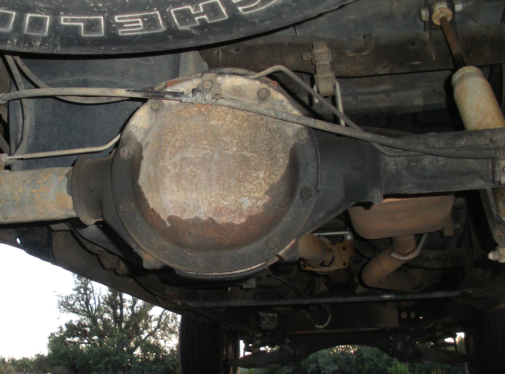

I was looking over my truck the other day and noticed that there is an abnormal moisture pattern on the rear differential. I have no idea whether or not this is normal or if it is a problem and there isn't any other moisture like this underneath the truck. If anyone has any ideas of what it might be let me know. Thanks.
Pics:
Cleanup the rear end with a good degreaser, replace the rear gasket and replace fluid. Monitor it for a few days to make sure it's still not leaking.
Also look at the pinion seal. Also look for oil being transferred to the diffy from further forward on the drive train. Trans rear seal or pan gasket. Engine rear seal. It doesn't take much to be blown back to show on the diffy.
