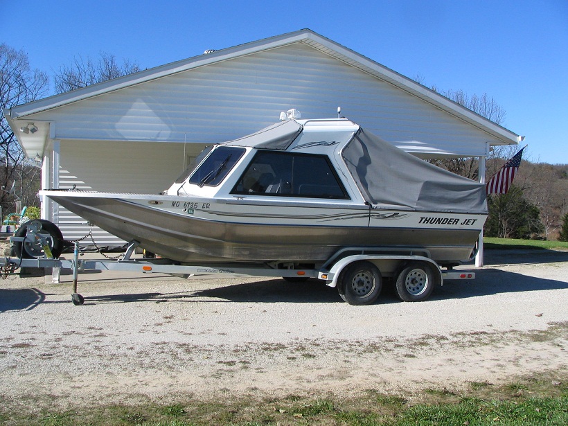

I run 2 Optima gel cell in my boat they are both about 5 years old and no problems. I run these for the abuse Jet boats on the river put on them. Lots of shock resistance.
In the winter charge them enough to keep the acid from freezing and becoming a dead zone of water. just my 2 cents.
