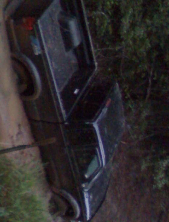

I recently bought a chevy s10 zr2 4x4 5 speed 4.3l baja MT tires on it. The 2nd day I had it I just had to take it down a mud trail and see what it could do. I mean be honest, who wouldn't wanna know what their truck is capable of? Well I found out and I know now. I find a mudhole and question whether or not I can make through and I did make it through but couldn't make it up the next hill due to the tires having no traction because of the mudhole and water. I put it in reverse and ended up stuck in the mudhole pretty deep. (I have a pic of it on request). I tried getting it out myself by dropping the clutch a few times and rockin it. I know now that it's probably not a good idea to do that but what's done is done. We eventually pulled it out and I actually drove it home and drove it the next day and that's when I could tell there was problems. It wasn't taking gear or anything. I managed to get it home and now it sits in the driveway. So my question is did i burn the clutch out or maybe is it something else? I doubt it's the drivetrain. I also understand it's hard to tell without really being there to see or drive (even though it just sits). I can turn it on just fine but for some reason i don't need to push the clutch to put it in gear, i can just switch gears as if it was an automatic and that's really weird to me, it just won't move. But i'm pretty sure the pressure plate and clutch are burned out from me rockin it in the mud by dropping the clutch. Thanks in advance for any advice!
