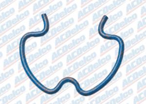

Fitting on cooler looks something like this: (left end of the pictured fitting is what I'm talking about)
It has a clip on it that you have to remove. To release the metal cooler line
Cooler pipe is captured in place by the clip.

could you use flat screwdriver to pop clip off or speacial tool to do this?

Small screwdriver or a tool with a hook on it works too.
