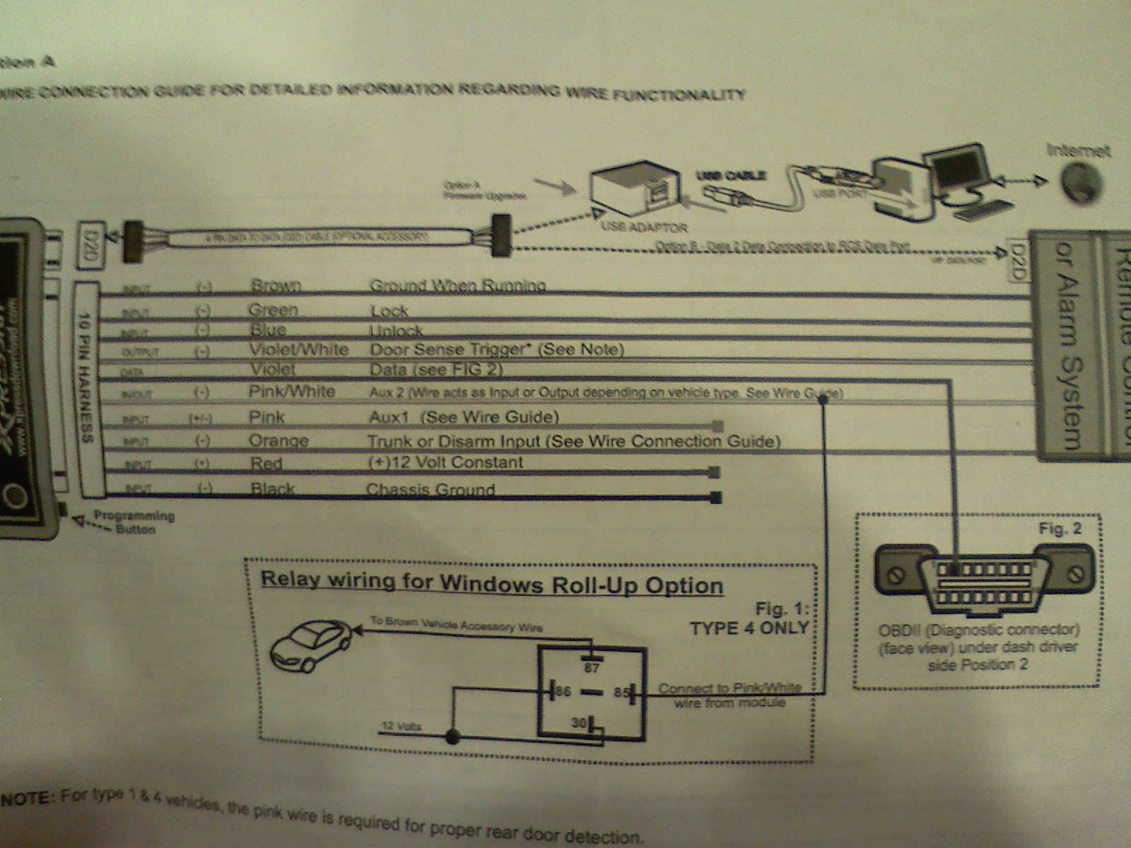

you still have to bypass the passlock system so you will still need a bypass module, such as an xk01 or something similar, the XK01 comes with the firmware preloaded so that if you get a remote start it will automatically turn the heated seats and defrosters on, it also makes the install much easier all the connections are between your aftermarket alarm/keyless/remote start brain to the XK01, the only connection you have to make to the truck is for the accessory ignition and starter kill, everything else such as door locks, lights and horn all go through the data line of the OBDII connector under your drivers side dash(i believe the data wire is the violet wire.)click here for more information on the XK01 bypass module!!
here is a wiring diagram i found for the XK01, click on the link above to find out more information.
