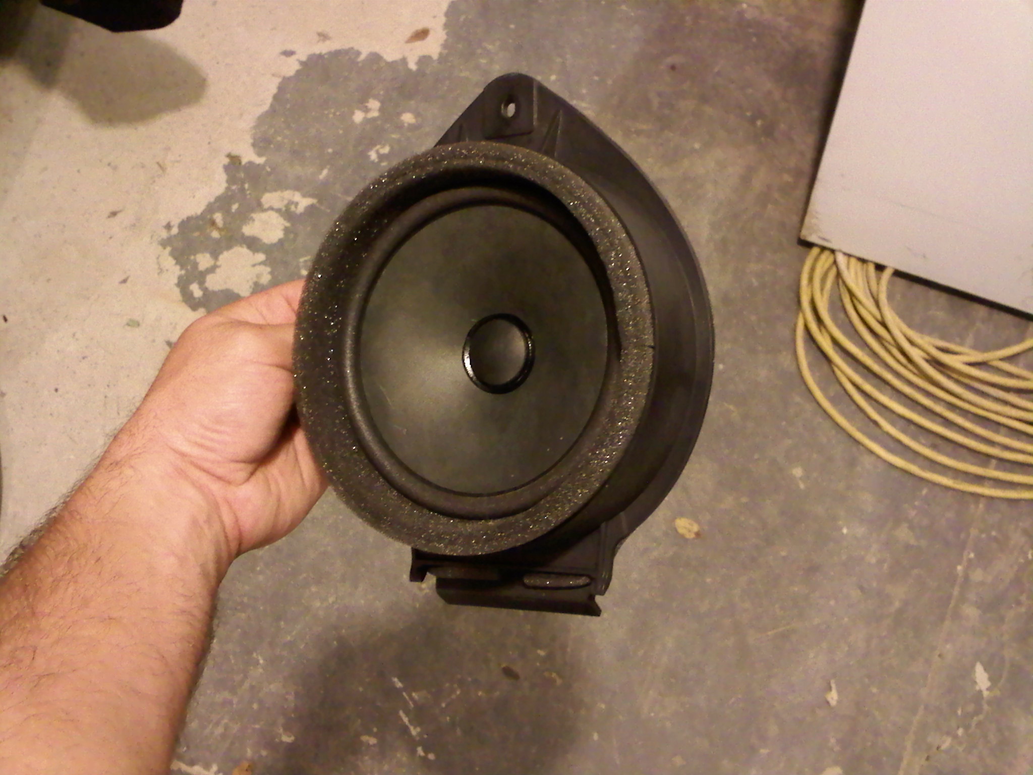

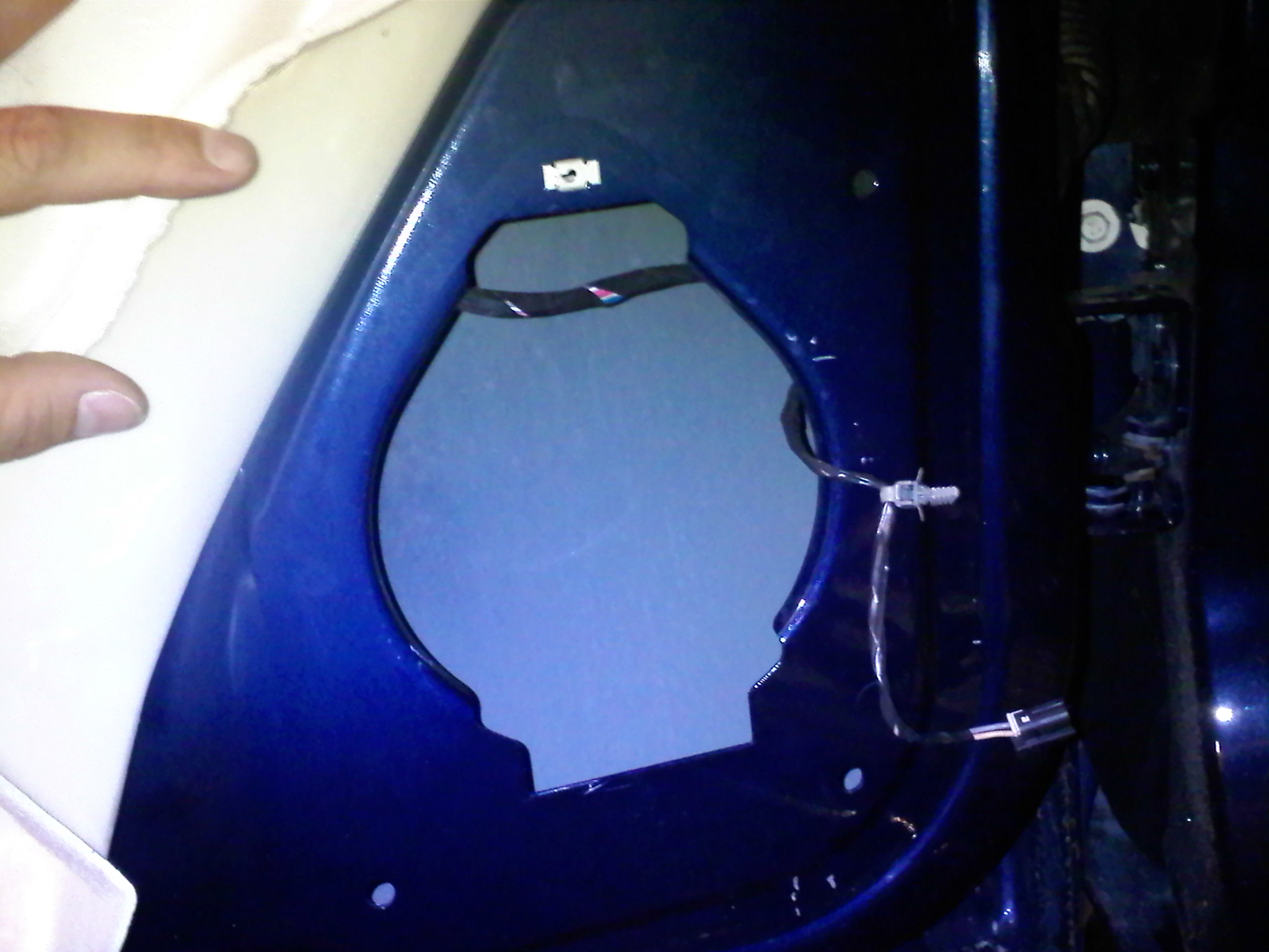

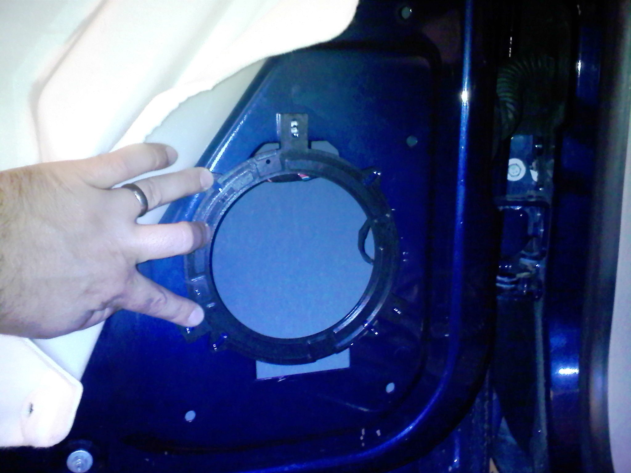

Well, I started to install my Infinity Reference speakers this evening and ran across something interesting. The hole in the door panel for the speakers is not just a round hole (see photo below). I have also attached the closest bracket that fits the hole. See that it doesn't fill the gaps below and above the speaker. Stock speaker shown at the bottom. Question is, will that effect the sound? Seems to me it would. Do I need to cut a peice of 1/4" plywood to cover the entire space, then mount. Any input ASAP would be greatly appreciated as I have my door torn down now, and would really like to get the speakers in before I have to put everything back together to drive it tomorrow.

I'd just put some dynamat behind the speakers and cover those gaps with it, personally. That would probably be better than using plywood since the wood will cause resonance at some frequencies, and that could actually be worse. The dynamat will just deaden resonance and allow the speakers to deliver a more "true" sound quality.

The stock speaker is molded into the adapter.

I installed infinity 6.5 in mine too. I got them from crutchfield and they came with brackets that look just like the factory ones and then you bolt the speaker to the bracket. The bracket goes on the door just like the orginal. They also included connecting wires, so I didnt have to cut in splice, so much easier.
Might want to check them out. They are made by Scosche (part number 142SMH634B)
