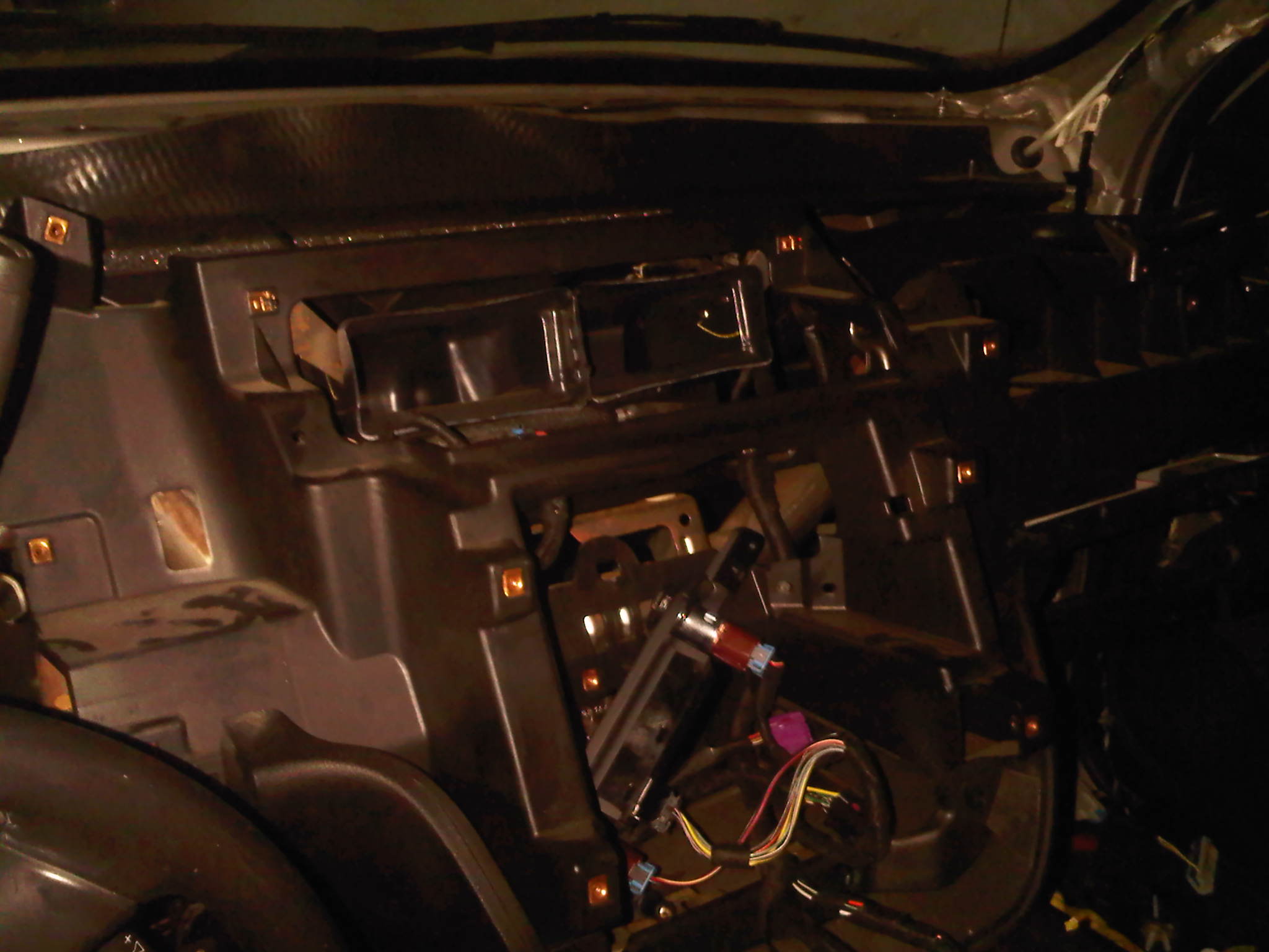

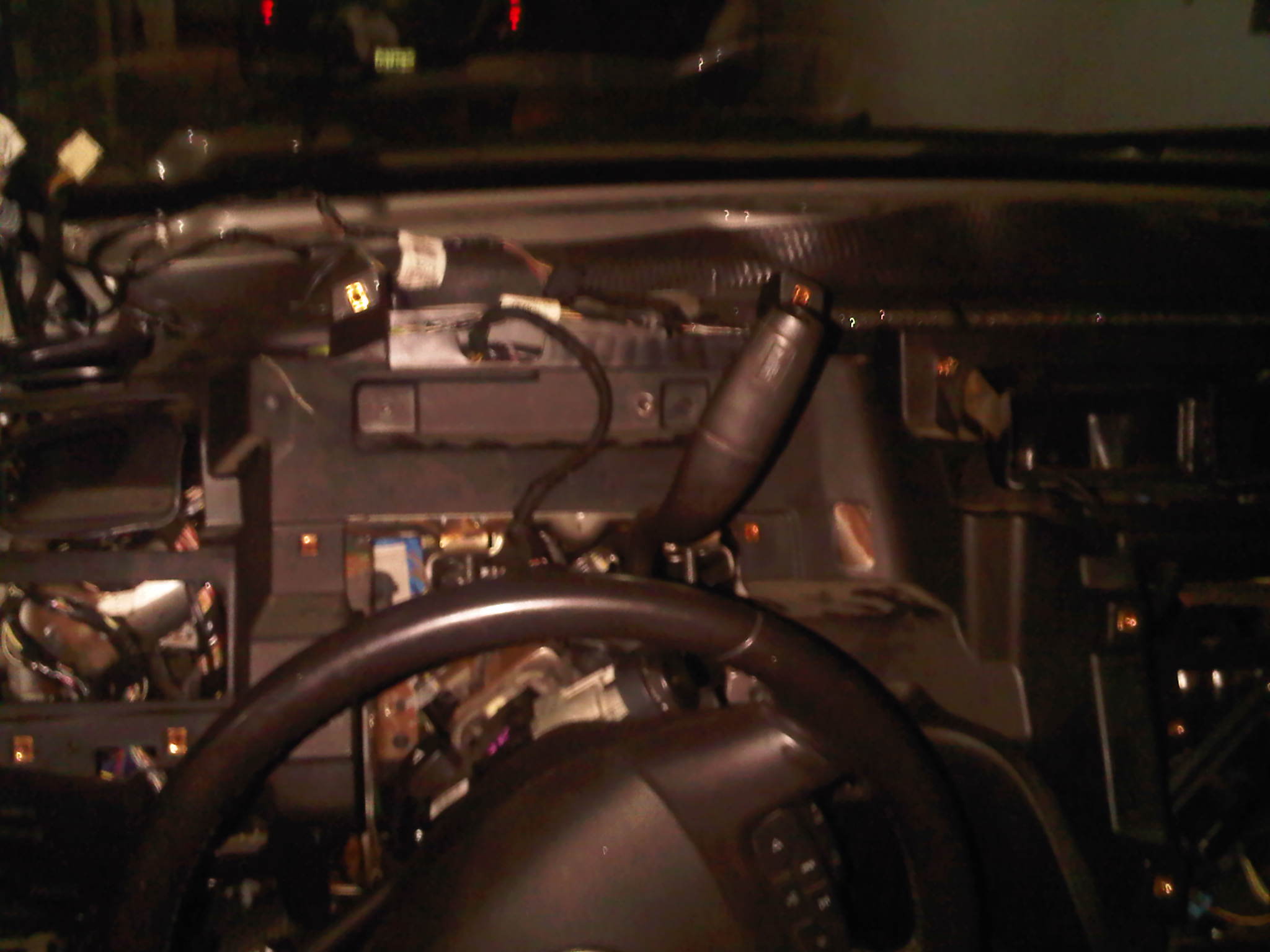

Ok, Here's how the job is going.

Here are pics of how we are doing it..
