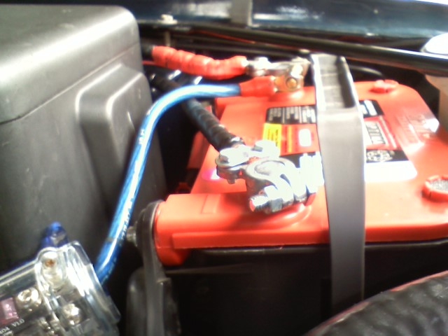

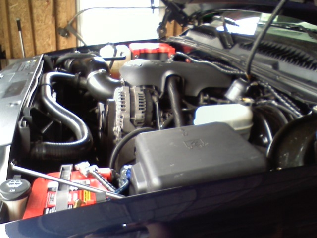

look up dual battery in the search bar, they are a couple threads on here, i put dual optima batteries in my truck just recently, i just ran wires off my original battery to second battery that i installed in the aux battery tray that i bought from gmpartsdirect.com. i posted pics of the setup on here too. now i have over 2000 cranking amps!!
