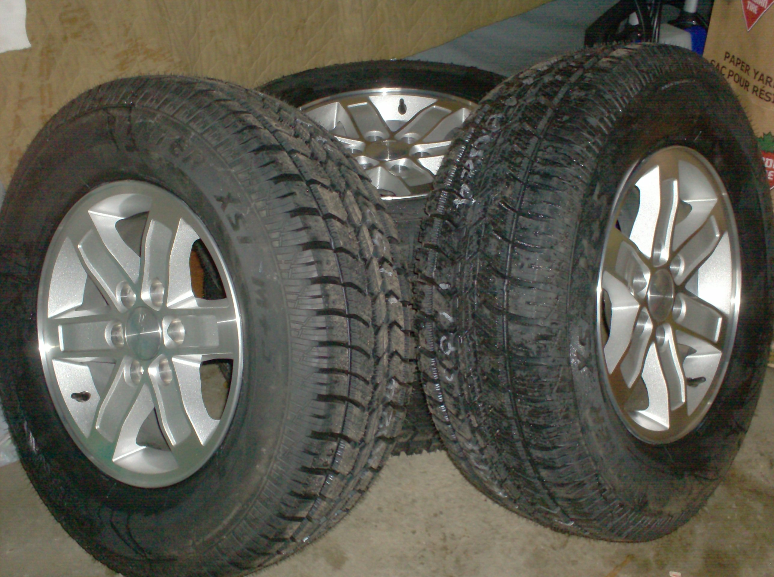

I just put my new snow tires/rims on yesterday and after I was done I noticed I had no idiot lights on or anything else?
All 4 summers came off and my new winters went on, why do I not see any warning lights on my dash?
The rims came with the TPM's but I did not reset, adjust anything, just removed the rears first then the fronts last.

Thanks for the link above Rod, I believe those numbers are the same numbers from my summer set? I had the right front tire removed at the dealer back in the fall due to an out of round tire issue with the cheap Good Year tires!
I never reset the TPM's when the wheel was reinstalled but I thought for sure after I changed them out to my new winter tires, I would see a warning light on the dash?
I believe the new set are all set at 35-40psi but I will verify that this wknd when I am resetting my TPM's?
