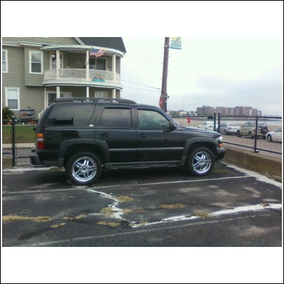

Can I also ask you what you run, an FMU or larger injectors? And what size wheels do you have, it looks great in your signature pic!

Thanks for the compliments on the wheels, they are 20X9.5" Weld Cheyenne 6s.
