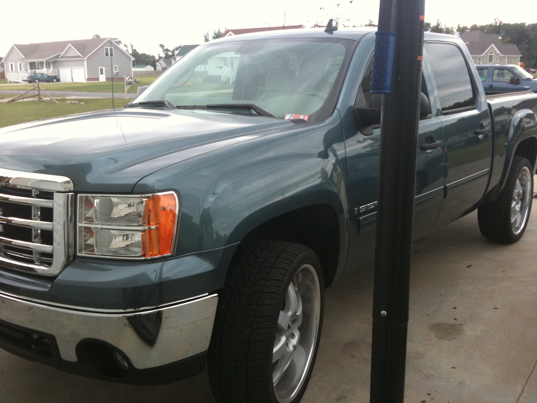

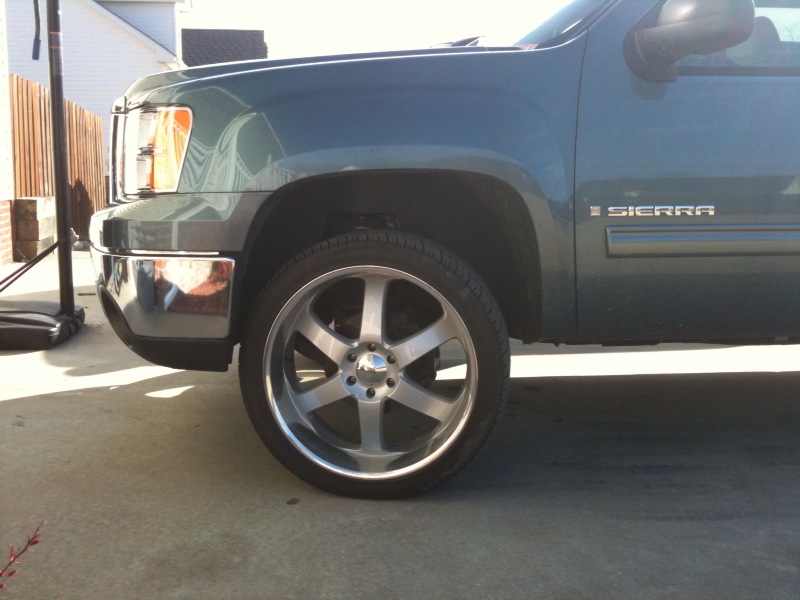

Haha they hold air. There is like 2 inches of sidewall maybe. Im actually suprised at how well they ride. The tread is pretty thick too its not like a street tire. Ill throw up a picture
305/35/24 soon to be powder coated charcoal gray. so you think a black bear tune would be good. Why exactly do I need to get it retuned? is it because gas mileage, speedo, transmission shift points?? just wondering. thanks
I dont like the look and its just not my style, but...... they are nice clean wheels, not to much going on. My biggest thing is that it makes the break rotors look so small, and I just like the meat of a tall tire, at least on a truck. Nice clean wheel though!
Might want to put some lock lugs on them, they could be worth some $$$$$ for someone else. Its happened to other people on here, even just the stock 20"
Thanks man. I actually dont like the look as much as i thought I would. my original plan was to put 35 or 38 inch tires on the 24's and jack it up. But Thats gonna happen after my warranty is up. So this will do for now. im gonna have them powder coated black cuz they are a pain the ass to clean.
