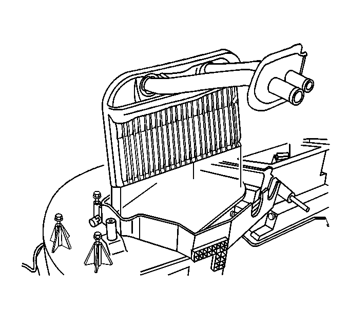

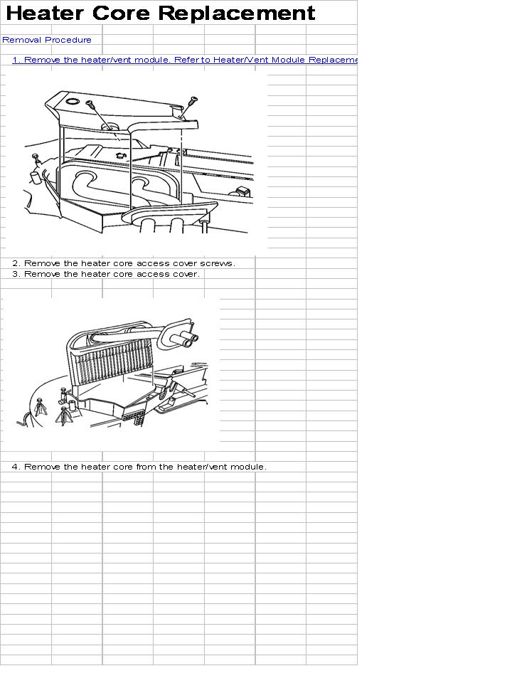

Heater core pics 1 tru 5
  1. <LI type=1>Remove the heater core access cover screws.
  2. Remove the heater core access cover.
  3. Remove the heater core from the heater/vent module.
