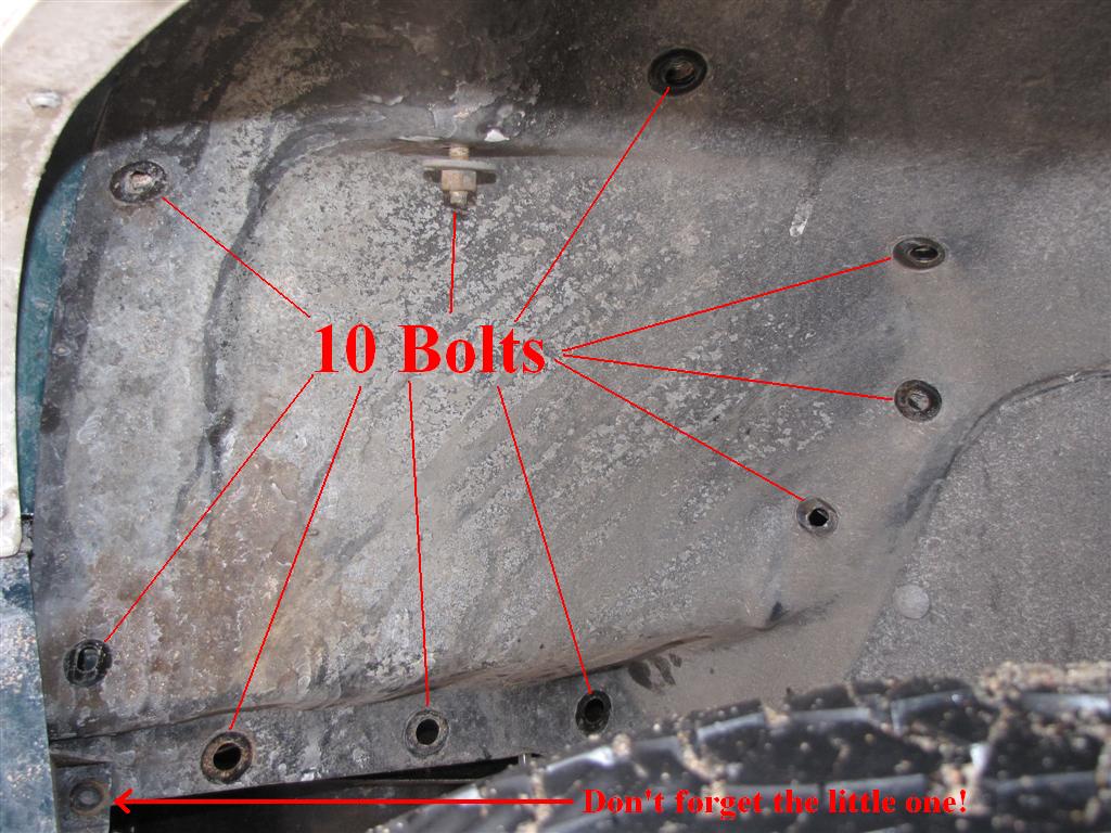

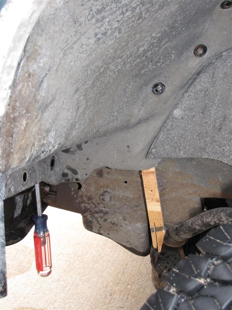

Well, I finally figured out how to drain the radiator. I used the pet-cock on the driver's side of the radiator. To get to it, I had to remove 10 bolts under the driver's side inner fender that bolt it to the frame and hold down the ECM. Then I pried the inner fender 2.5 inches away from the frame rail so I could get my hand up to turn the pet-cock. The pet-cock on mine was white. I could barely see it by looking down from above. The pet-cock turns less that a quarter turn before it stops. Don't be overly alarmed by this. It takes a little more pressure to get it open. Once you get it broke loose, it only takes a little more than half a turn to open it. The pet-cock does not come out of the radiator. It acts like a spicket and only lets the coolant out at a controlled rate. The upside to this is that it doesn't piss completely all over the place but the downside is that you can't get the big chunks of rust/contaminants out. I jacked up the passenger side of the truck about 2-3 inches; just enough to tilt the truck.
