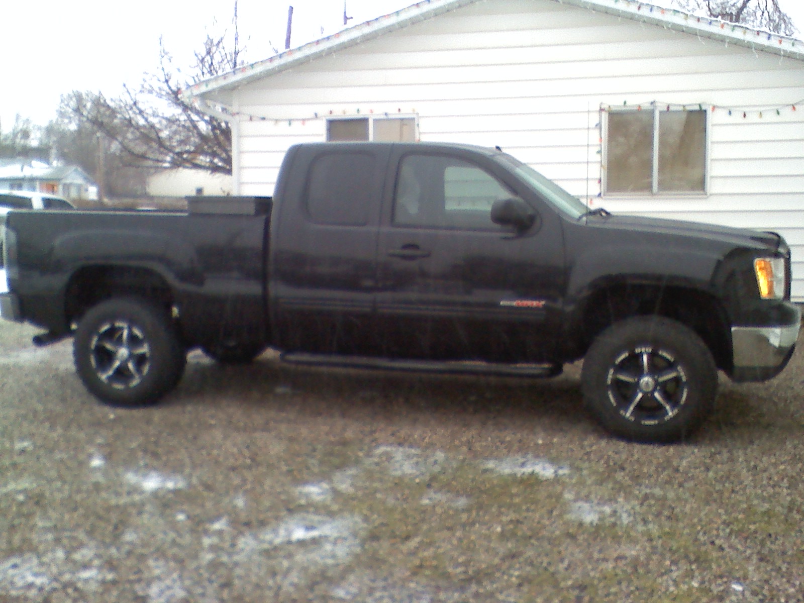

sorry for the bad pic, i think the snow was messing with my phones camera. 3.5" skyjacker front lift with readylift 3" rear blocks. the skyjcker kit is advertized as a 3", but has grooves for a snap ring to adjust the lift to 3.5. my tires are 285/70/17.
Thanks for the pic Jamey- truck looks great. I've ordered the RC 2" kit and I need to find somewhere local to get the Readylift 3" blocks as I'm not paying $40US to ship it up here. Ridiculous.
