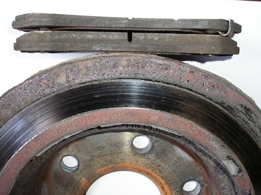

Thought you might like this picture off my 2002 Silverado Front - still braked fine, it was the wear indicator that gave things away. Only had about 30K on the truck.
Mike
