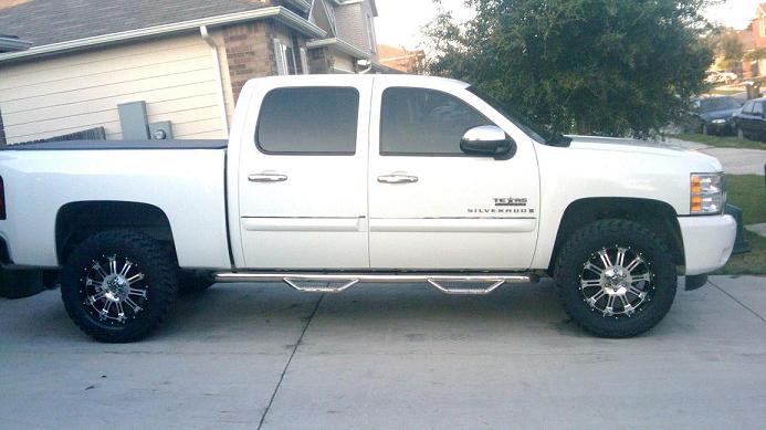

Just like what Matt said before, the 1.5 would better on your steering and suspension components. However, if I was only going to do 1.5, I wouldn't even mess with it. I have the setup you are taking about except I have the ccm 2.5 and 3" blocks in the rear. You will have about 1" of rake that isn't really that noticable. I have had a leveling kit for close to 30,000 miles with no problems what so ever. I'm sure they will wear out the front end quicker, but who knows how much quicker? Balljoints go out at 100,000 instead of 140,000? Who knows? Didn't bother me because I haven't kept a truck for more than 60,000 miles in 10 years and Ive had 6 different ones. So I didn't even consider it.
Looks real good!
I actually prefer the rake and wouldn't like it if it was totally even.

I actually love the stance of his truck as well.

Yeah, I like his truck too. A little to much rake for me, but still looks good. I think he just has a 3" Body lift, and nothing up front or back. I have the zone 1.5 in my garage I will be adding this summer when I get a chance for around 4" of lift. Good luck with the mods.

I have a Readylift leveling kit on my truck originally and it totally leveled out the truck, I then added BD lift blocks to the rear to get the rake back. If you look at the pics of my Truck this is the 2.5" level with 3" rear block.
