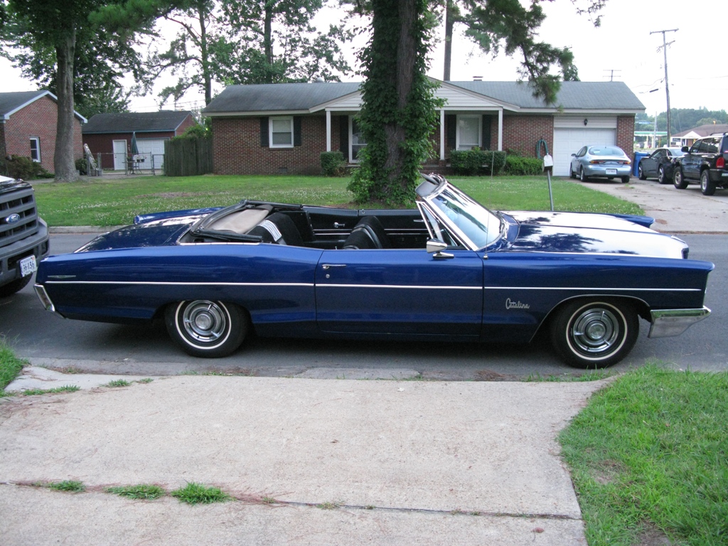

That Catalina is beautiful!!! My dad had a 389 4bbl 66 catalina 4 door when I was sixteen, that car would rip the tires loose and cruise the highway like floating on a cloud. Loved it. Sweet Poncho you got! Post more pics.
